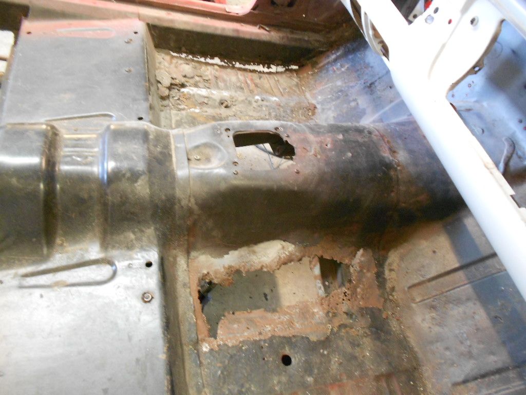

Because the subframe connectors were welded to the rear torque box the frame rail and rear floorboard was damaged but it stopped here.
You never know what is inside your rocker panels
The floors had been patched with fiberglass a long time ago.
