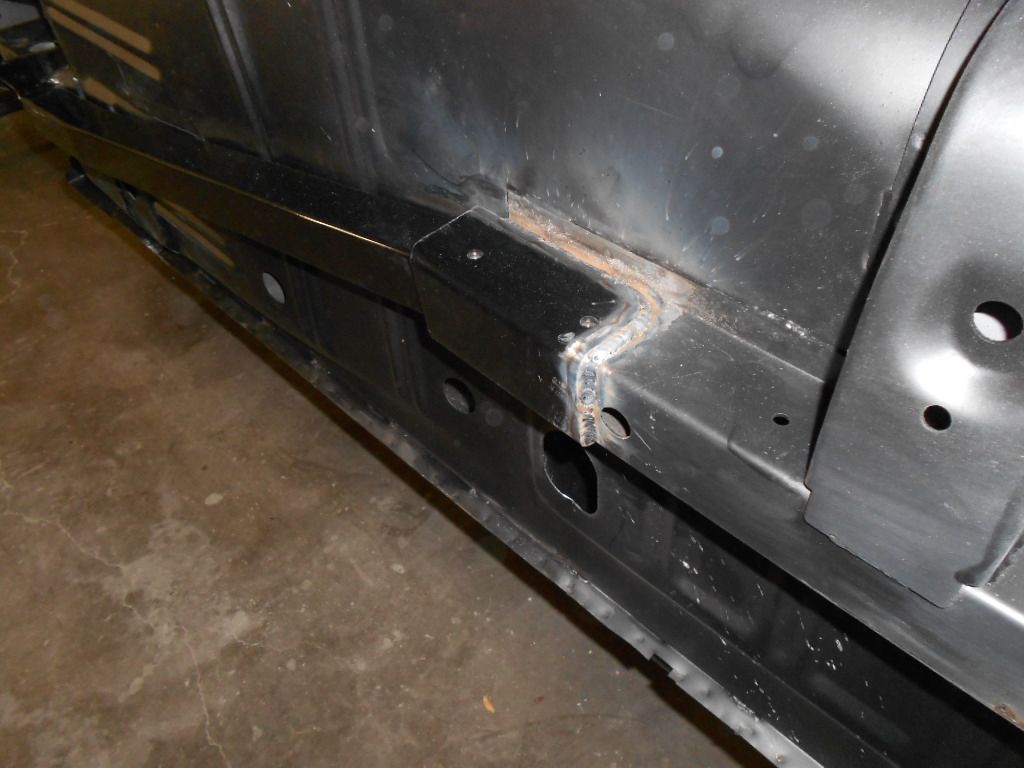

Installing the TCP subframe connectors. The minimum clearance between the factory frame rail where the subframe connectors attach in the front is 27 1/8" the Dynacorn body was 27 1/2" so were were okay.
Once we had them welded in place we went to test fit the center brace and it would not fit in the back. Dynacorn welded the frame rails in the wrong place. The distance between the frame rails is 1/2" narrower than stock spec in the front and 1/4" in the rear behind the shackle mounts. We will have to modify the TCP center brace.
