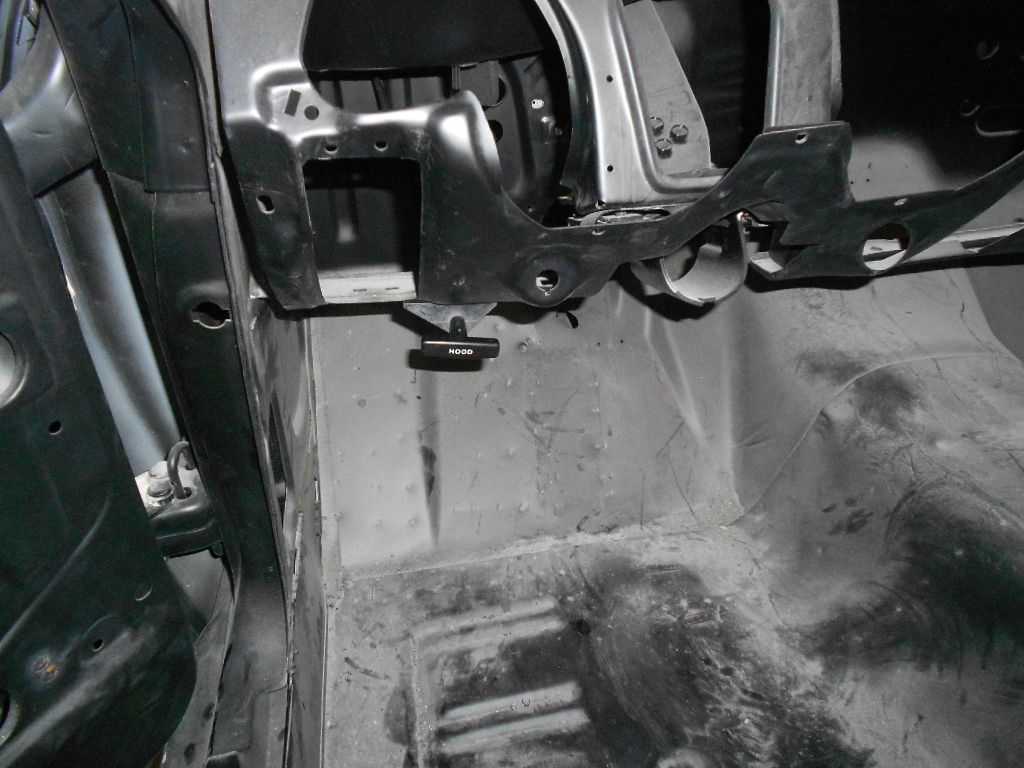

We have been working on a couple of things I can't show at this time. A modified lower front valance and a future story in Modified Mustangs & Fords magazine showing a period correct looking hood latch with an under the dash hood release.
But I can show this
This is what Brian has been fabricating. It is an under the dash hood release. The hood required a lot of fabrication along with this latch that came off of another Ford. To find out all the details you will have to read the build story in an upcoming issue of Modified Mustangs & Fords magazine.

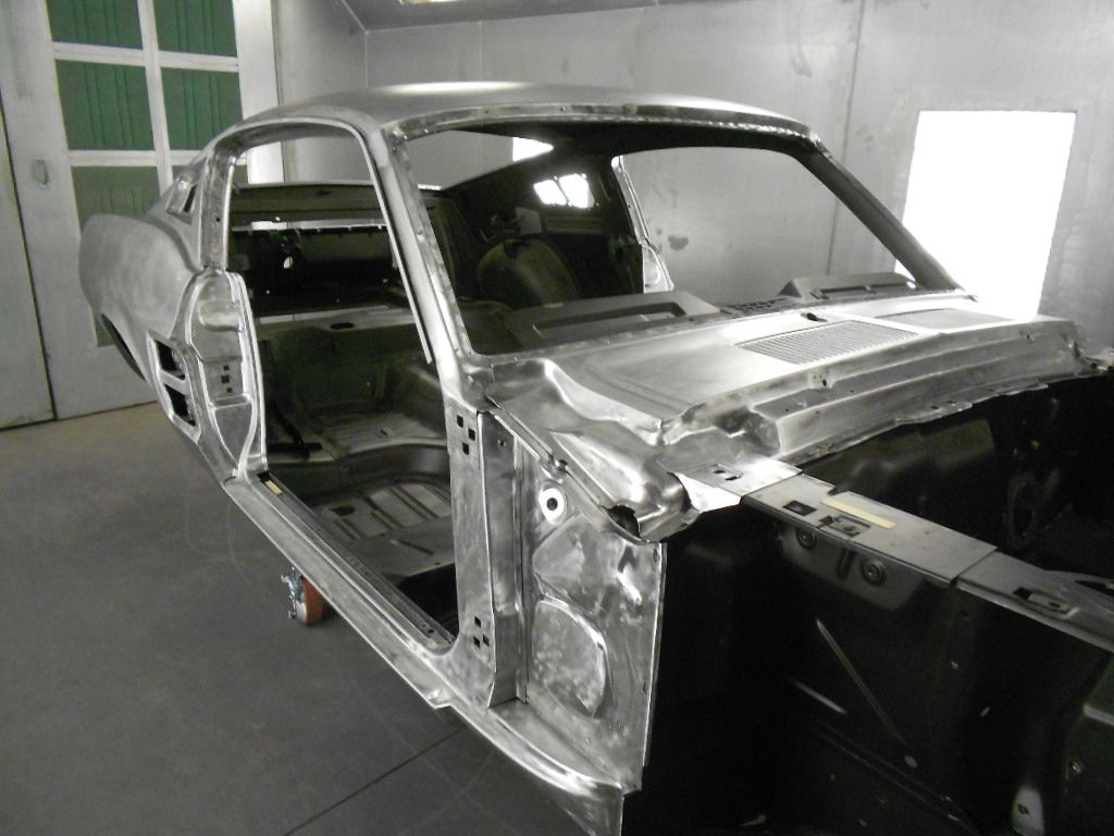

The body was sanded down to bare metal and the next step is spray 2 coats of SPI black epoxy

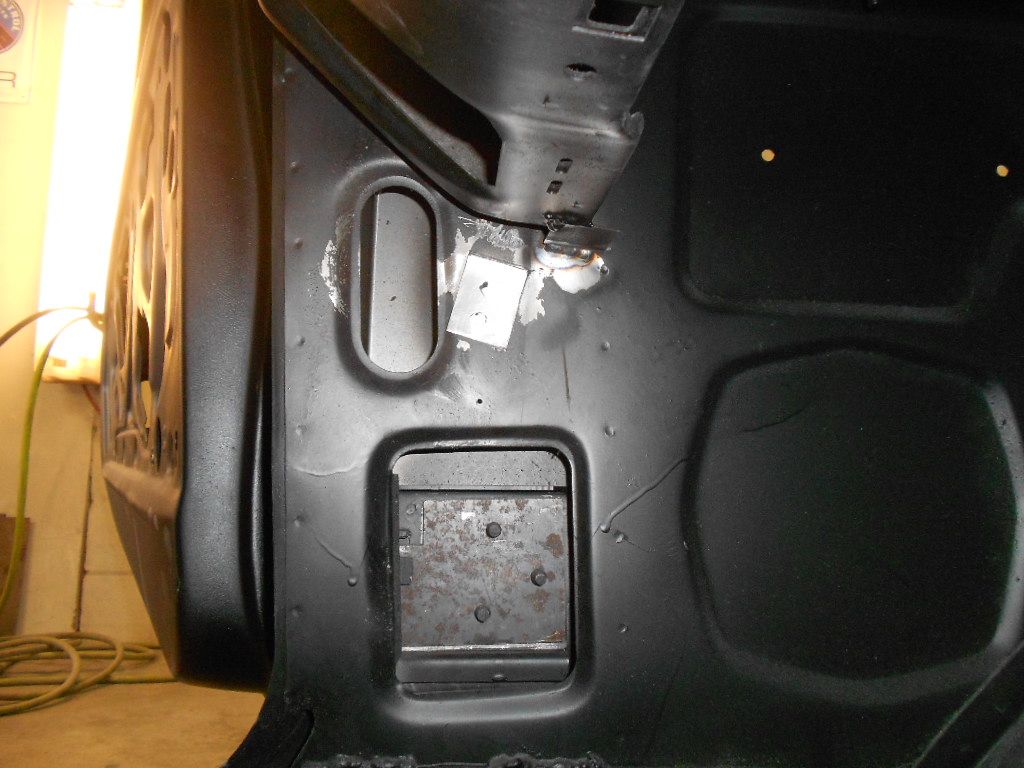

The rear valance had a tack weld and also bolts.
Instead of studs on the valance Dynacorn used 2 different size bolts and washers from inside the trunk and attached to clips on the valance
We wanted to take off the rear valance to see what was behind it and just as I thought bare metal and surface rust

"B67FSTB" said:
Why not welding the rear Valance in place ??
I would do it if I did it again.
I did it on my car after epoxy priming everything first but the owner of this car wants it to look original.
We now have a new helper in the shop and he was busy sanding down to bare metal
I sprayed two coats of SPI black epoxy yesterday

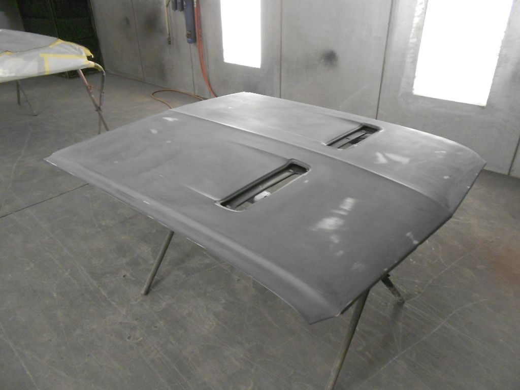

Block sanded the hood and doors

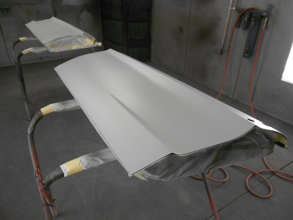

Sprayed one coat of SPI black epoxy to seal than sprayed 2 coats of Slick Sand Polyester primer
