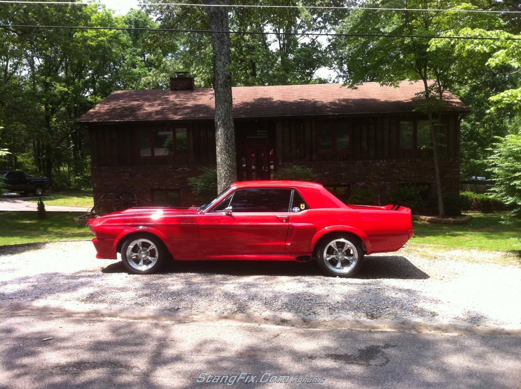

Got any pics of the car? We like pics :pbj
Jon
pics as requested. As she sits today:
What would be a good leaf spring/shock combo for the rear to raise it a little bit for that muscle car stance? Or does that affect performance driving at the track?

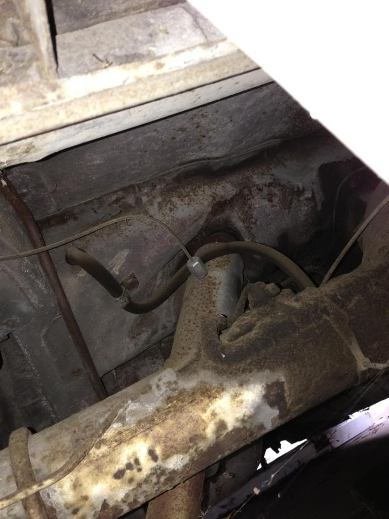

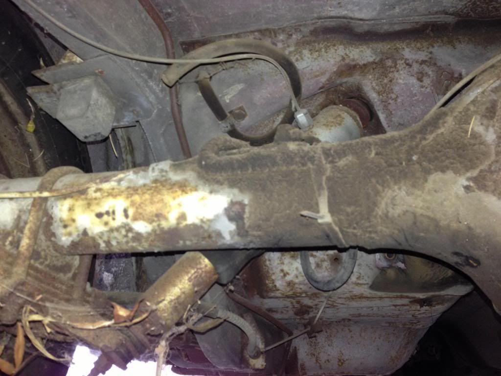

So I looked underneath the car and snapped some pictures. It looks strong where the shocks are mounted to. Are they really that weak? Where can I gain access to the top of the shock towers? I didn't easily find them unless they are under the back seat.
you need to pull the seat. also should remove the shocks to get a good look at the area to inspect for cracks. they would originate around the hole the upper shock stud comes through.
on a coupe you can access them with out pulling the seat but it's a lot easier with the seat out. There should be two rubber plugs (oval shape) in the access hole on the front side of the hump over the axle.
great pics. Thank you. Now that I know what I'm looking for I will try again. So I should remove the air shocks and get some new lefts in the rear along with some new shocks? I'm thinking its not a bolt on job to do coil springs in the rear or coil overs, so really my only bolt in option is new springs/shocks front and rear?

It sits a bit low in the back for m personally. I wouldn't mind being able to raise it up just a little bit. I think it may lean a little to the passengers side as well. Air shocks are obviously fully empty. I was just thinking if I take the shocks up and try to sell them and get a couple bucks for the air shocks and the stock springs, might be able to get something I put in and know the condition and it might not be much more as I got a set of front coils with some other parts I picked up a while ago.

The ride height in the pics does look low but not too bad. Of course weight will lower it more. What wheels and Tires are you planning? If they don't rub, you can always change the springs later and do the gas shocks. You probably won't get anything for the used air shocks and the old springs would be worth more as scrap than to some else.
I was thinking of 17's so I can do larger brakes for sudden stops, track days/strip and course, etc. With the 351c it sits low in the front already without any lowering springs etc. Would be nice to start to get a plan and understanding of options so I can get it set up right the first time. would like to feel confident in the car no matter what I do with it.
