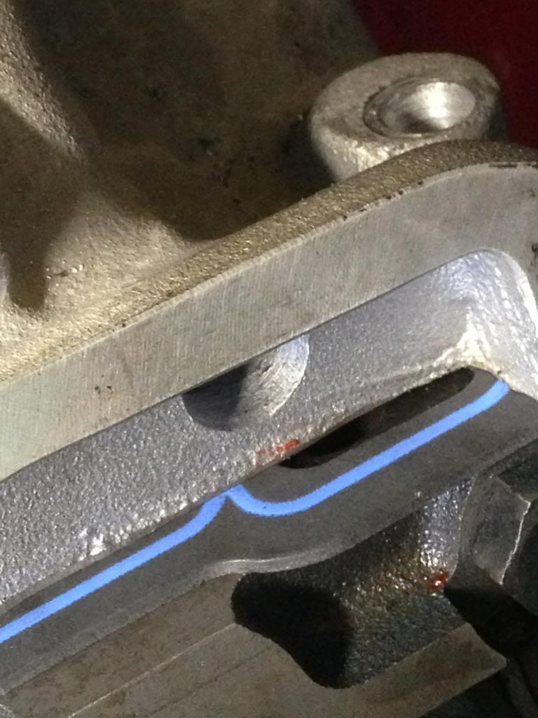

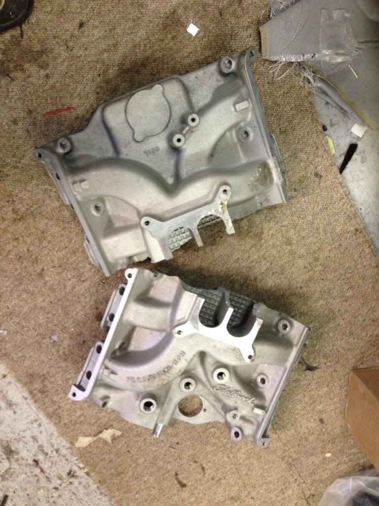

We stripped the intake off but no major signs of loose bolts, leaks, etc
I drained the oil pan and there was about 2 gallons of water in it. The bellhousing was also full of water and overflowing out onto the ground.
I thought that it may be one of frost expansion plugs that came loose/leaked which would explain the water in the bell housing but that would not explain the water in the oil pan. And the rate at which it was leaking looks more like an open hole rather than a weeping/leaking. I spoke to an engine builder here in Ireland and he mentioned that there may be a plug on the front and back of the block that the original engine builder might've forgotten to put in during the build. I have drained and flushed the motor with diesel to get the water out of it. We plan to check the motor then blank all the ports on the water system and pressure test it, then do the same with the intake. I read online that getting a good seal between the heads/intake can be a challenge with these motors. Any tips on this?
