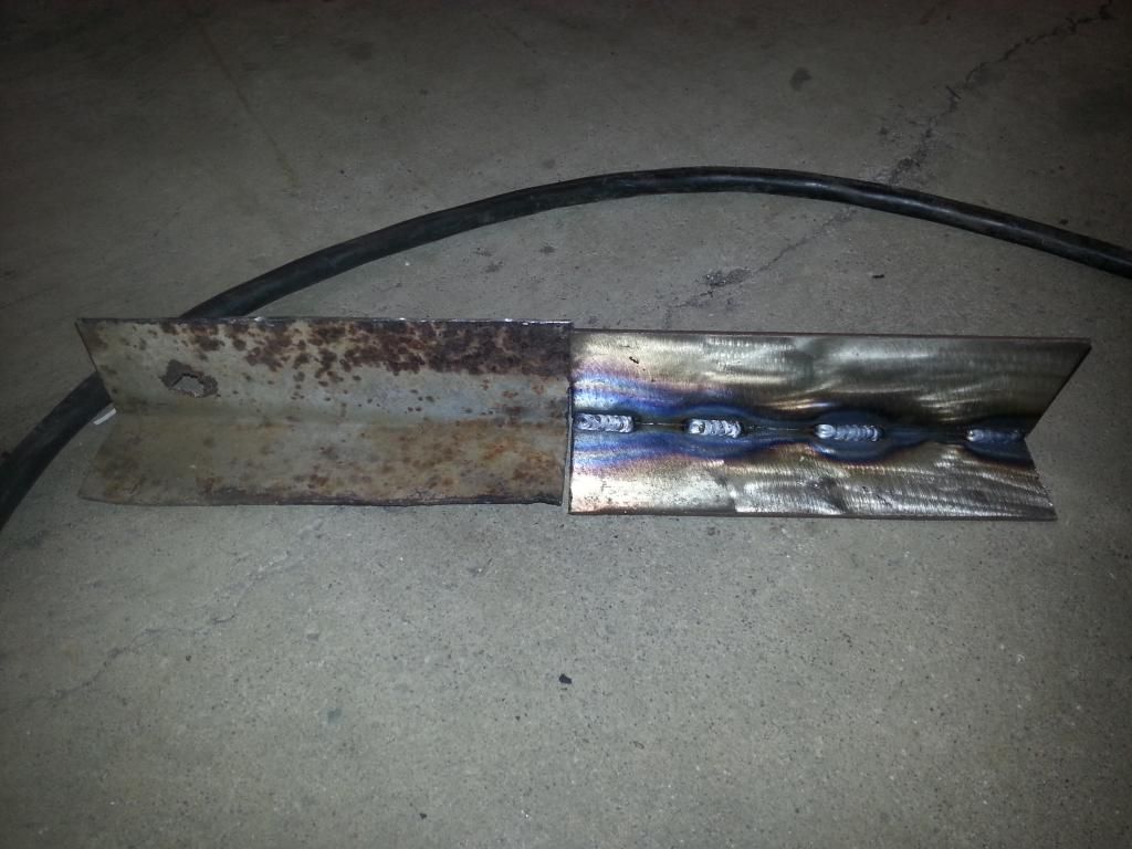

Bottom of passenger frame had a rust hole made a new piece....
Cut out and ready for fitment and welding...
Ground down and ready to go...
Passenger firewall and kickpanel welded in.
