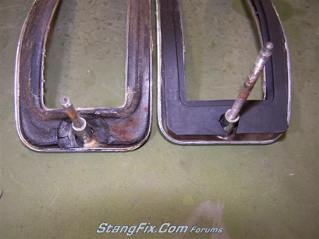

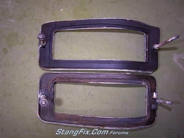

I'm in the process of finishing my taillight upgrade/leak fix. I bought all new seals for the job from NPD before I started, and stoopidly toss my old ones when I pulled them. Two issues I have:
The new taillight to body seals are hard rubber, and don't fit well. The old ones were soft foam like material, and fit quite well. I can't get the hard rubber to seal well - even where they fit well, they don't conform well to the body.
Anybody out there know of better light to body seals?
Issue 2 - the old seals on the trim were in 3 parts - one that fit into the trim, and two grommet like seals around the studs (which fell apart when removed). The new ones don't have these, and they are not listed anywhere I can find them. Looking at the new seals, it's a leak waiting to happen.
Anybody have a source for the grommets?

I used the NPD seals with new bezels (originals were very pitted), and I thought they fit very good. I was happy with the fit, in that the seals kept the bezels JUST off of the fresh paint.
I did not have any round grommet pieces on my 67 tail light seals, and I've never heard of needing additional rubber grommets around the studs. Sounds like something the previous owner installed. Since your seals are new, I don't see why you'd need additional grommets. If you're concerned about sealing around the threaded posts just use a small amount of 3m strip caulk. The 3m strip caulk comes in handy in many different spots, like between front fender & apron, around rear bumper mounting bolts, etc.

Now that I look at it, I think that may be what was in the old ones. Guess somebody tried to stop the leaks with something like the 3M stuff, but the stuff they used is hard as a rock. Although it looks pretty uniform, it would be hard to do that with strip caulk I'd think <shrug>.

You need to realize that those aren’t really seals. They’re just pads to keep the chrome off the paint (chipping). Originals and all the repops I’ve seen are the foam rubber type. Someone may have decided that the regular rubber type are better and/or cheaper, and are making them that way, now.
Regardless, I agree that it's wise to put something around the stems to seal that hole.
The big pad on the inside is the actual seal. But, those also are also "hard" rubber nowadays. They’re too hard IMO. I would supplement them with either strip caulk or that 3M Bedding & Glazing Compound (caulk tube). Every '67/'68 I've worked on has suffered rust (sometimes severe) as a result of watter getting between the big seal and the body - poor design.
