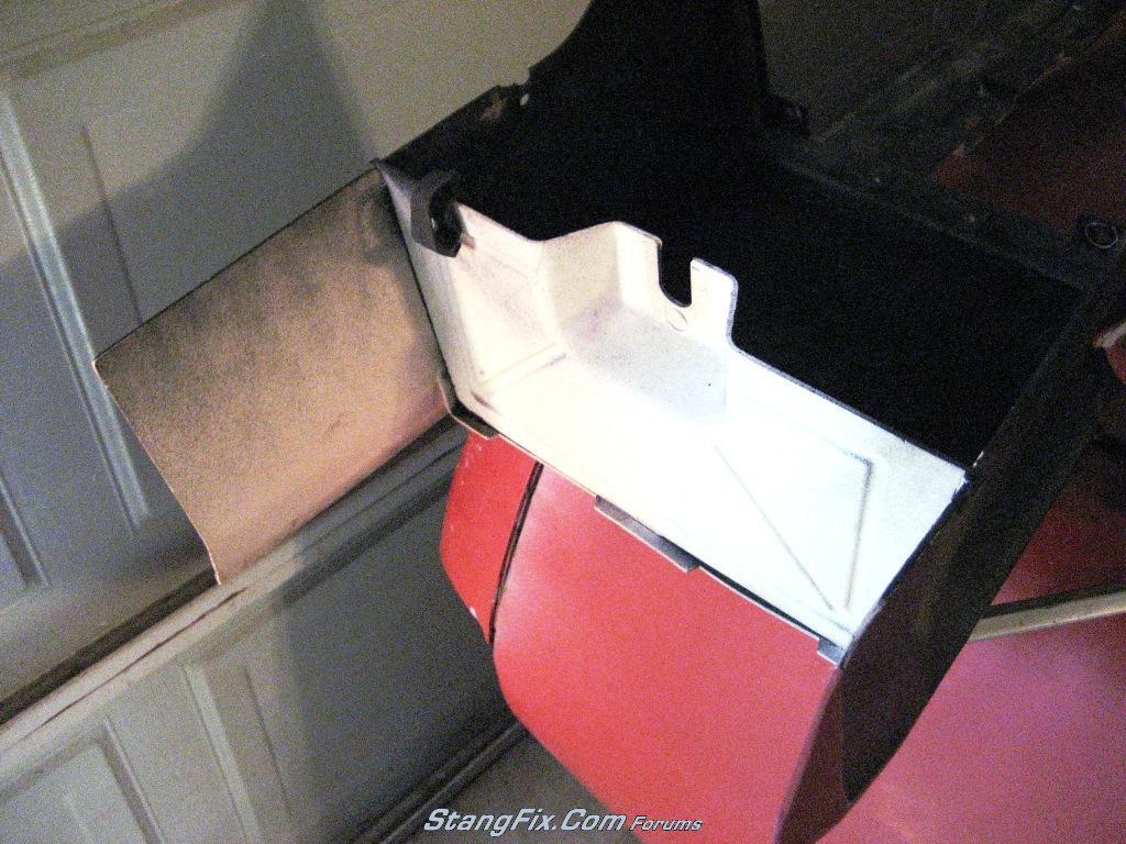

Mike: The line for cutting is usually about an inch past the back of the console compartment end piece.

I don't think it was a crude cut at all, maybe if A/C was added later or something. The red one in that car is the original and the car did have factory A/C (although it was upgraded to the perfect fit CAA kit.) If I remember right, there is a line that shows where to cut if you have the non A/C version.

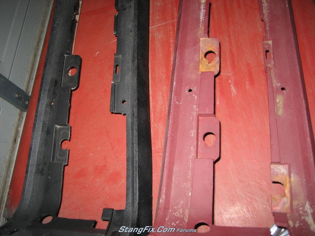

I will snap some pics of both, the auto console will have to be cut on because the manual hole is off-set more. It's not a big deal as the top plate will cover your cuts.

Here is a pic of a auto and manual console. The black one is for a manual and the red one for an auto. You can see the notch or cut-out for the manual.

back to the OP, mine must be non-AC as they are long? ZI don't see a line either, where should it be?
