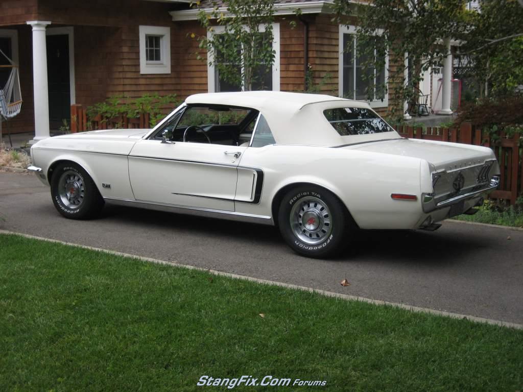

Dateline 9-22-10********* Here are the latest pics**********

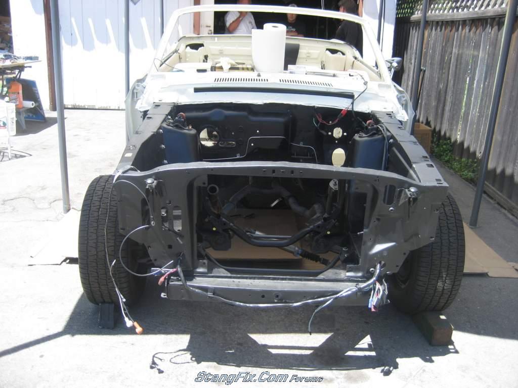

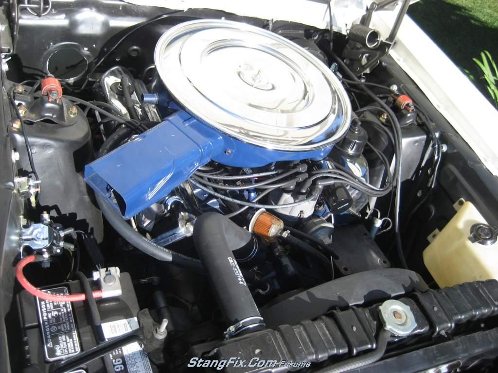

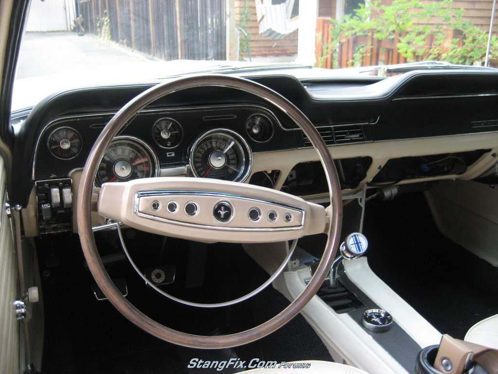

I apologize for the lack of posts on the project progress, but I have been busy. Right now the car is at the trim shop having the new topping and rear curtain installed. It should be done by Tuesday so I'll have an opportunity to take some pics and post them here next week. SInce the last update in April, the engine/trans has been installed and broken in (thanks to Craig & Justin for their help) The power steeering components were refurbished and installed; the glass has been installed and aligned; the weatherstripping has been installed; the bolt on body panels have been installed and aligned; the engine compartment has received all new wiring; rebuilt master cylinder and brake booster have been intalled; grill, lights, bumpers, and shiny trim has all been installed. Remaining tasks include the A/C, the steering wheel refurbishing, the rest of the interior, the GT stripes, rocker panel moldings and a few other odds and ends. I also need to get under the car again to adjust the shift linkage as it is a bit clunky and hangs up occasionally. Lastly, courtesy of Frank, we have a set of black plates with a '68 tag that will be going on shortly.********

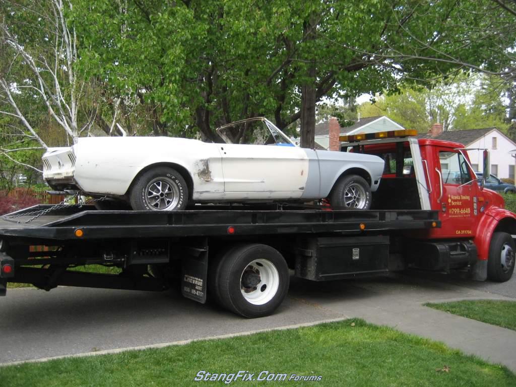

The car was carted off to paint a week ago. Enjoy.....

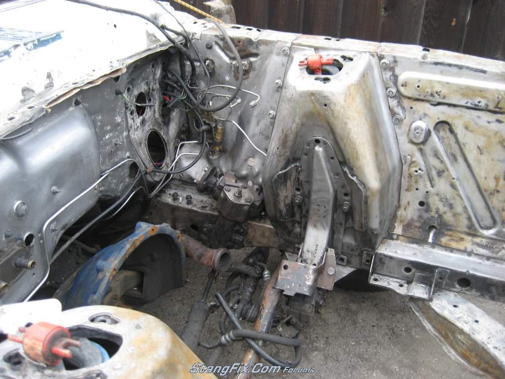

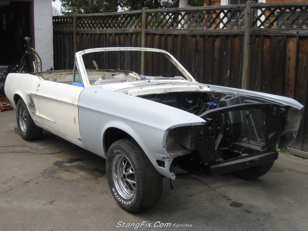

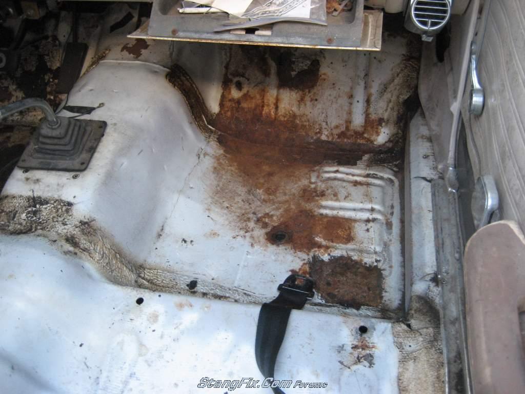

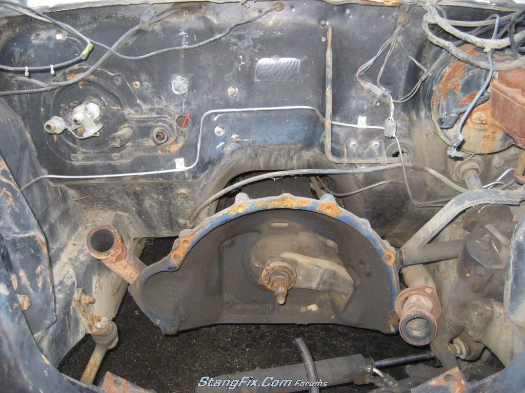

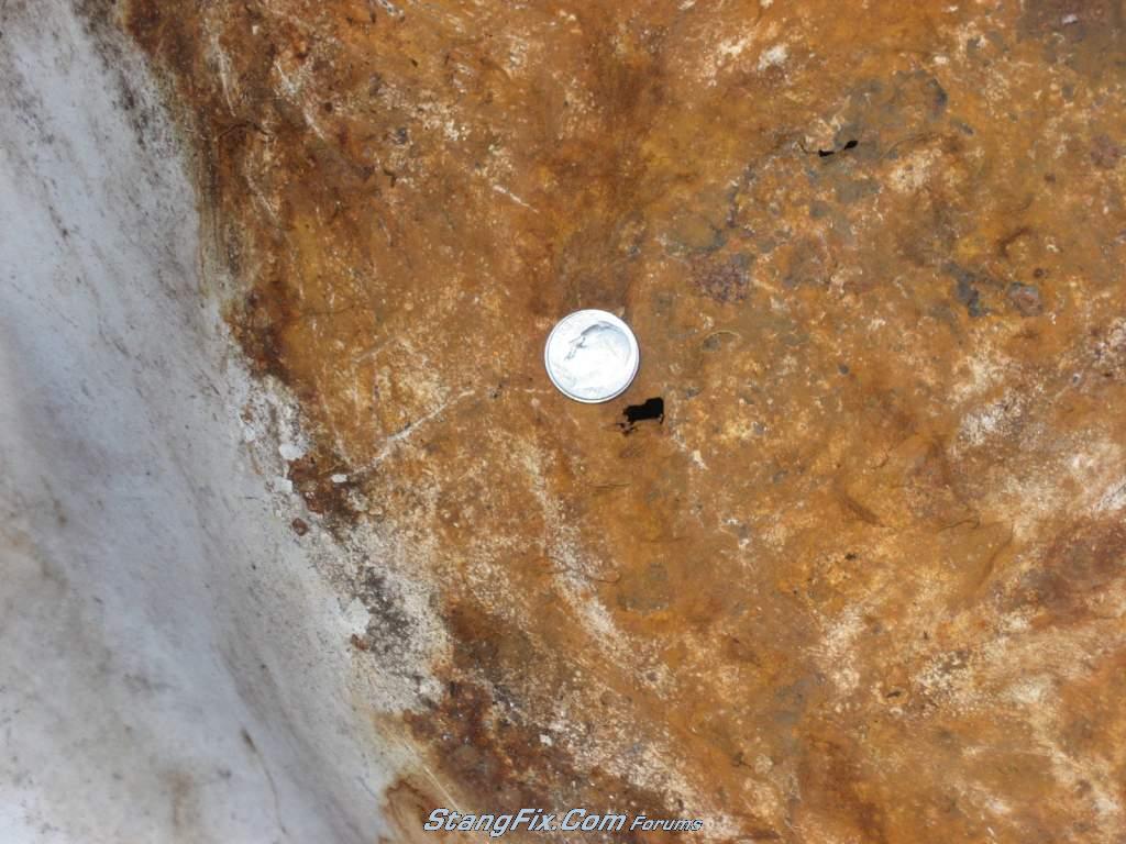

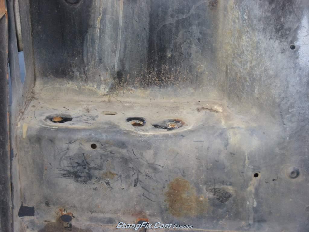

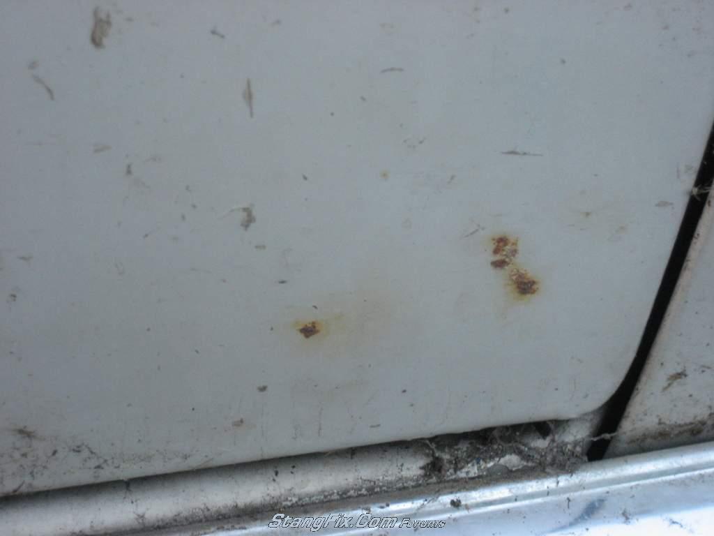

I finally had a chance to snap some post disassembly shots of the car I picked up a couple of weeks ago. I continue to be amazed at how solid the car is....the floor rust consits of a couple of holes smaller than a dime!! At any rate, here is the first installment .........
Also, the Marti report came in and the car appears to be a substantially original San Jose built, San Francisco White over Parchment (1 of 89) car with the following options:

Weather permitting, I hope to have the engine bay stripped and detailed along with the front suspension and steering within the next several days.

Jeff, that car is going to be a great project! I am incredibly jealous of your lack of rust on that thing. Fantastic. Sounds like you'll be driving her in no time.

Looks great Jeff. Do I see a Shelby drop there in the shock tower shot. I do not know that I ever seen a white on white Mustang before. Are you planning on original or are the plans still up in the air? fd

If you could find and post up a picture of a completley rotted torque box.... or better yet.... a lower cowl panel.... that would be great. Lie to me, I don't care. I'd just like to feel better about you having the car and not me.

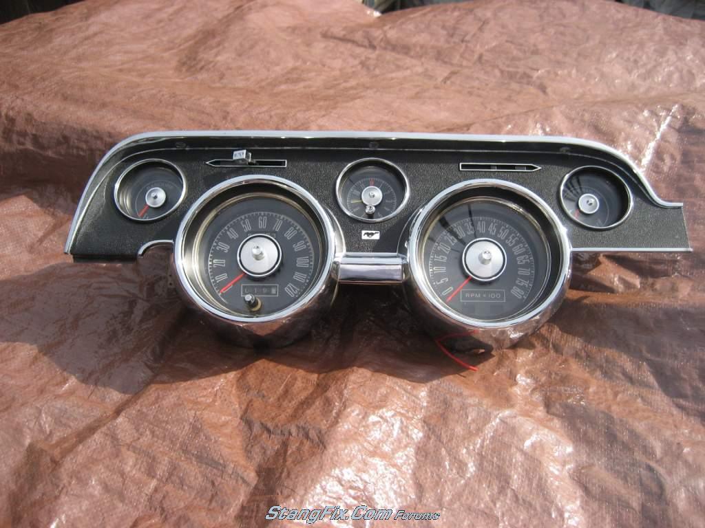

I know it's been a while since the last installment but the weather here has been unusually lousy so the bulk of my efforts have been doing small things like refurbishing the instrument cluster, refinishing the hub caps and gas cap, inventorying the loose parts that came with the car, media blasting a bunch of small parts and continuing with developing the parts list. This afternoon we picked up the freshened engine from the machine shop and got it home and installed on an engine stand......all the while dealing with a downpour and flooded gutters. I've got to take the starter and alternator in for testing and refurbishing as necessary. The carb that came with the car is not original and the list # is not something Holley admits to having made!!! I'm heading over to Goodies with the carb and see which 4160 kit will work. As soon as the sky clears, (tomorrow maybe) I will get some updated pics up for viewing.

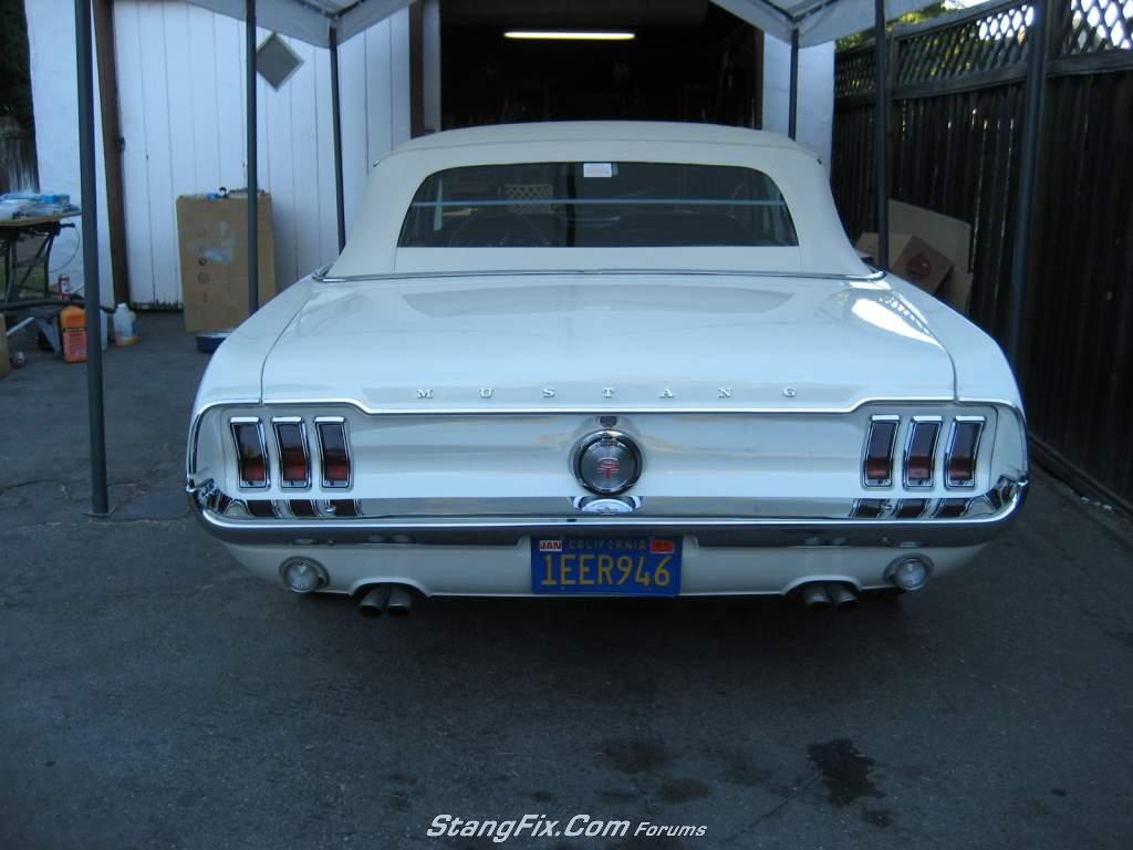

Re: '68 390 GT Convert project update 8-24-10

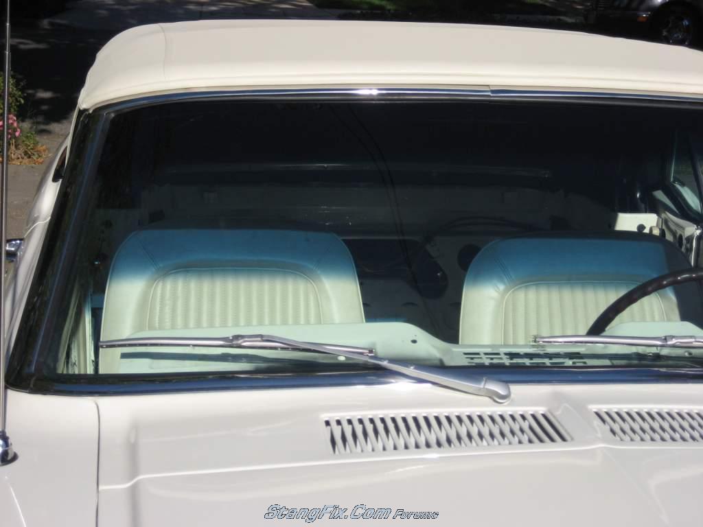

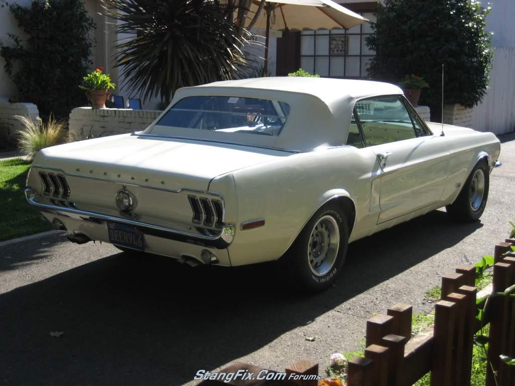

Here are the pics I promised the other day. They include the engine drop, the first drive around the block after the engine drop, and all of the body pieces that have rejoined the car since the last set of pics. Also is the new top that was installed over the past couple of days. There are some odds and ends in the form of trim and stripes on the exterior and then the rest of the interior and it should be done. Enjoy:
