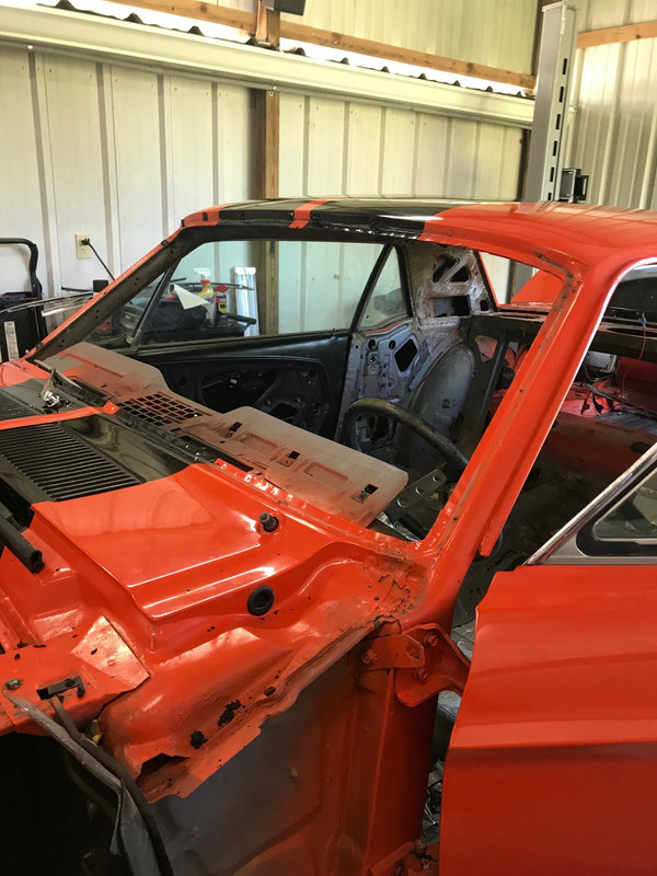

Today, still removing stuff from the cab area, where you ride area? It's just about empty; still have the brake booster/ steering column to get out, oh then remove the brake pedal assembly since I'll be adding a clutch. Actually the inside looks pretty good, not sure what I'll do, maybe Rustbullet or POR15, then the tuffmat.

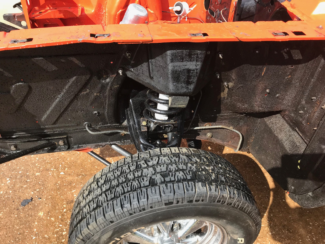

Regarding the upper control arms on both sides, the ball joint rubbers are torn towards the outside. Is there a limiter of travel when the car is lifted off the ground? I don't have to tend to this right now, but easier with the fenders off. I was thinking getting the UCA's with the rubber bushings instead of the greasable type. But still like to know why the rubber parts are torn. I was thinking it may be the wrong shocks allowing too much travel, but really don't know.
Oh what a nice day here in Cypress, Tx, the cool front passed through; great day to roll the stang out and pressure wash it(again). It cleaned up pretty good, now to pull out the steering/brake pedal assembly, not sure about the gas tank yet. Probably should remove it, there was a lot of water in the tank which became a little 'redish' when I drained most of the gas.
I had been looking at the one piece headliners, and I thought they were like a 130 bucks, but Nooooo! I'm trying to be frugal, so back to the original headliner. So, pulled out the front and rear glass. Wasn't bad at all. Darn it, still need to pull out the steering column and brake pedal assembly~ doah!;)

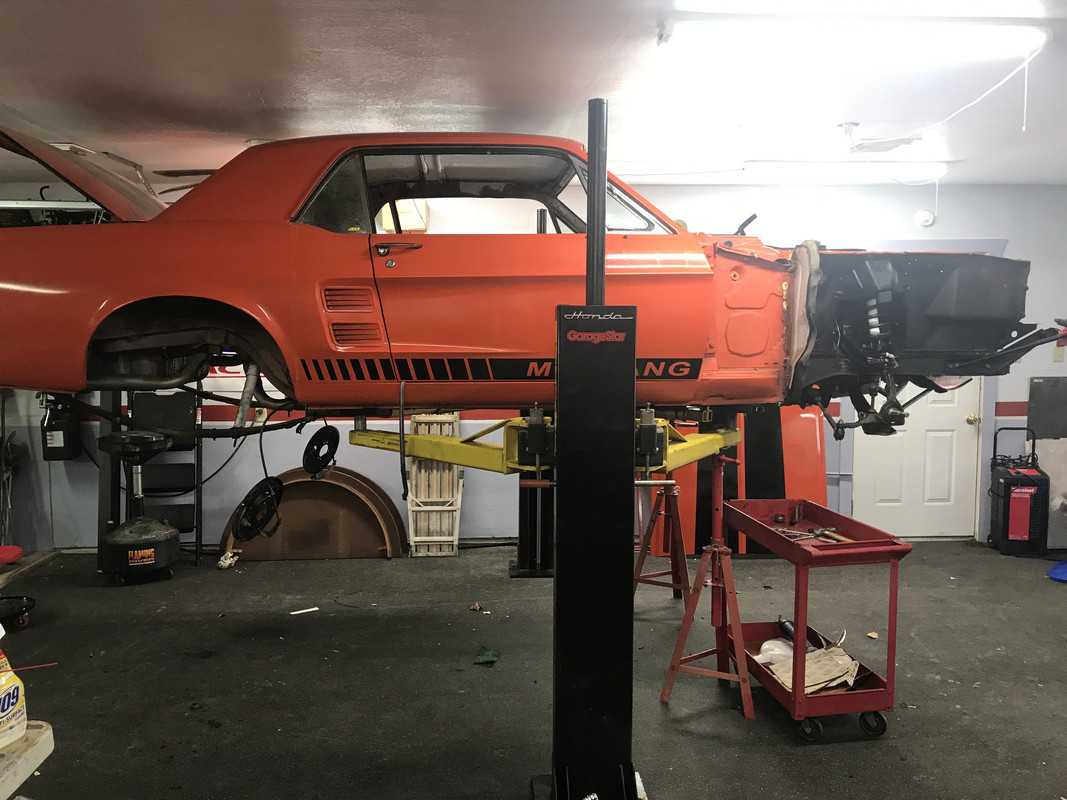

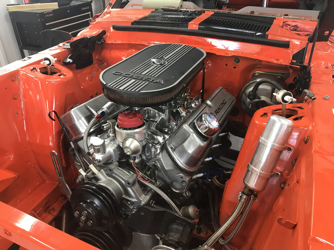

After finally getting the 5.0 and 5 speed trans installed, Gary help me move the Stang to the other part of the shop where it's AC/heat is and closer to my main tool box!

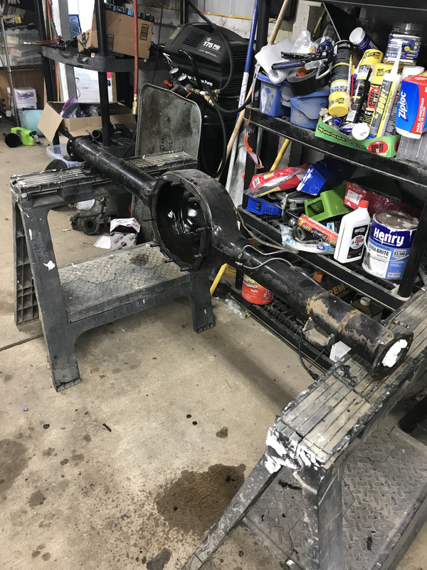

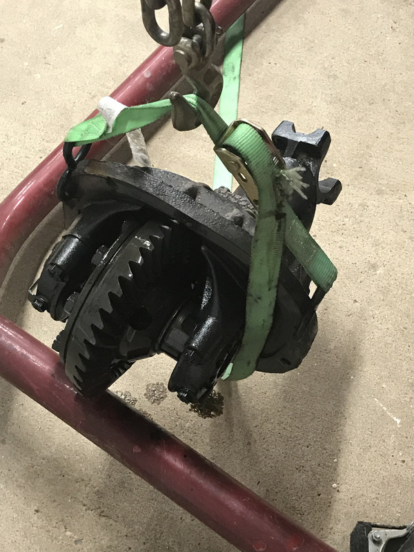

The question I have here is, choosing a ratio for the pumpkin?? How do I choose since having a 5 speed manual trans? The stock diff was a 2:79. I found a place on Ebay which sells third members with choice of limited slip and whatever ratio. However, I'm going to look around Houston, surely there is a builder around here.

I have a T5 five speed in my car. I've logged over 700 miles on it this summer between shows and cruises. City and highway driving. It's seen it all. I can tell you that something in the line of a 3.55 or more is where you want to be. I went 3.80 in mine. Could have gone 4.11 without much worry but wanted to be comfortable on long highway drives across country so came down a notch. Launch is really good but even at 75 mph on the open road the rpm is well below 3k.
I would recommend looking into a TruTrac as opposed to a Ford unit. {.} advised me to go that route as he has one in his race car and likes it. I have to say I think it is probably the best "posi" unit you can put in a rearend. I had mine set up at Quickperformance.com (they are in Ames, IA) and can't say enough good things about them. Hope this helps.
I have a 3.50 behind the T5 and it seems to be a great combo. First gear is almost unusable, so I can’t imagine how it would feel with a 4.11 or something that deep. I need to shift to second before I clear the crosswalks!
I could see going as far as 3.75 but no further to have a comfortable rpm at elevated highway speeds.

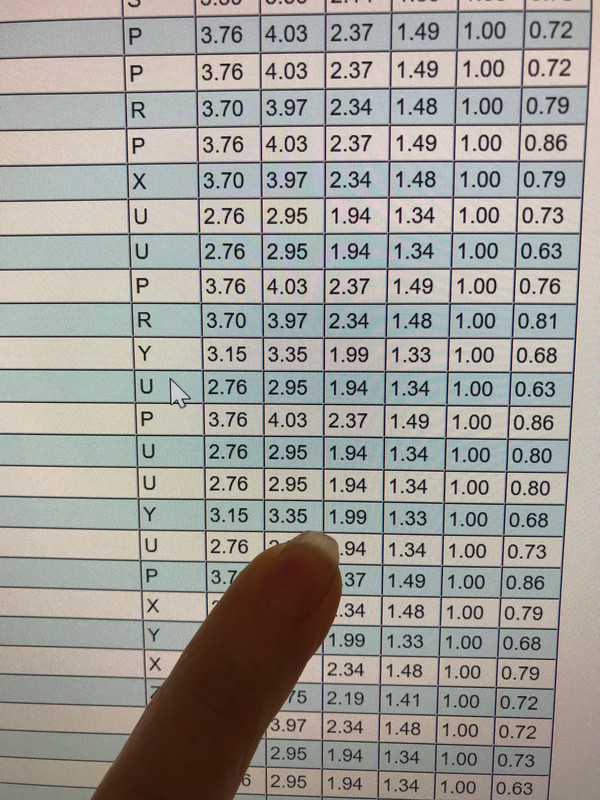

All T5's are not created equal. Thanks for the reminder, Ken. Yours likely has the dreaded 3.35 1st gear. Standard on 90's mustangs. I have a better 2.95 1st in mine. I'd agree if you have one of those trans a lower numerical gear would be wise but in fifth (overdrive) you can easily run a 3.80...I'm doing it!
Gee guys, thank you for the input. I looked up the gearing for my T5 and the numbers actually mean little to me! lol I'd hate to know I wouldn't be able to use 1st gear, but looking forward to a good top end with lowered rpms. We all do! So if I went with the 3.80 and below, I'd be OK? I'll look into the Tru-track Terry! ;)
http://www.mongosgarage.com/tech/t5/T5Numbers.PDF
You've got the same trans as Ken. You'll want to keep your rear gear closer to a 3.50 if you expect to do any volume of highway driving in excess of 60/65 mph. You can find an online calculator where you enter your vehicle speed, tire size, transmission and rear end gear ratios to find out what kind of rpm the engine will be turning if you really want to know where things will end up.
