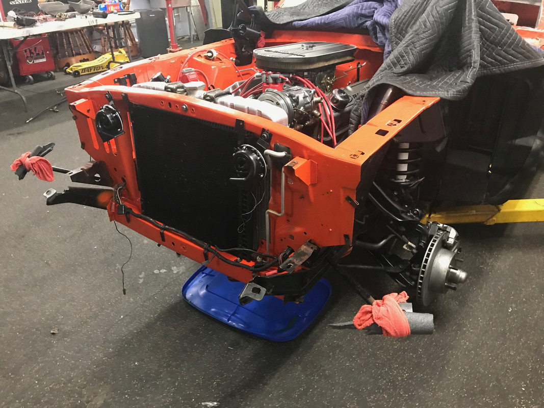

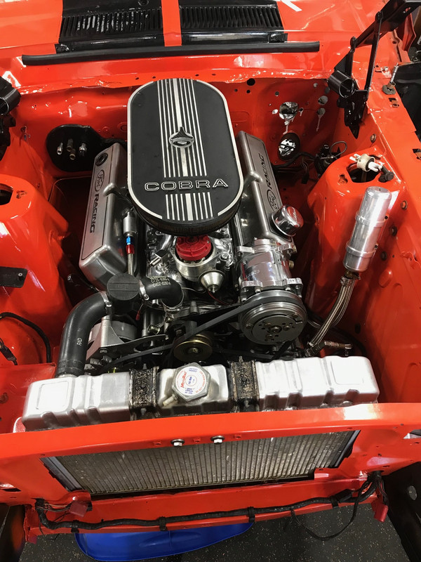

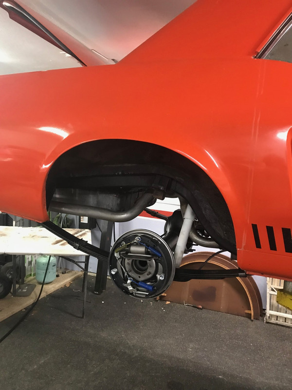

Other stuff going on: rear brakes installed, new axle bearings, (waiting on the 3:55 dif), overhauled the front calipers, a bunch of parts have arrived. I'm waiting on the newly designed McCleod hydraulic clutch mc/slave. I guess if I could be left alone I could get something done! lol Still stuff going on here, working through flood related crap, and working on my moms home.
AC comp installed, radiator(need to blast the radiator holder), I'm sure there's something I'm missing to say/write. I'm going to take a chance on the distributor, but did get a new blaster coil, new starter solenoid of course, I'll be back;)

What I've done: Front and rear brakes, axle bearings, radiator/condensor/compressor, elec radiator fans, starter solenoid, electronic voltage regulator, (all dash switches on the workbench), Waiting on new sequential turn signal lamps.
Also waiting on 3:55 third member~ should be here soon then I can wrap up the differential! oh, should be able to install headliner, windshield/rear glass maybe next week. I have a new gas tank/sender on the way. The gas was just too rusty looking and gas tanks are relatively cheap. It's an "easy" replacement.

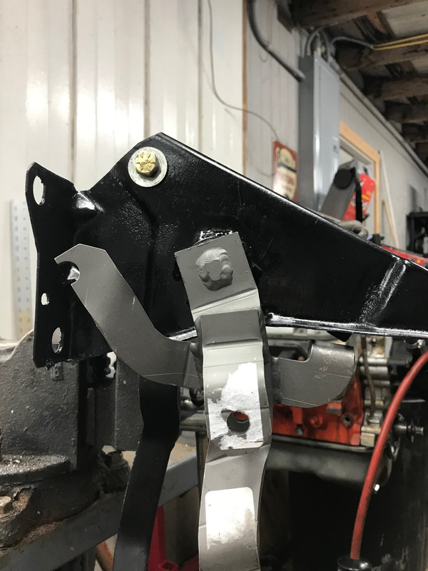

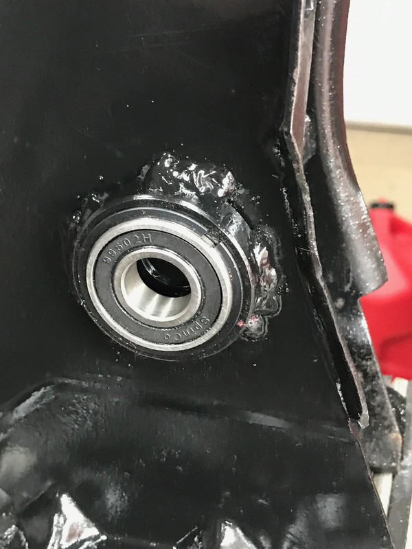

I'll be upgrading the clutch pedal with bearings instead of plastic bushings(need to do that).

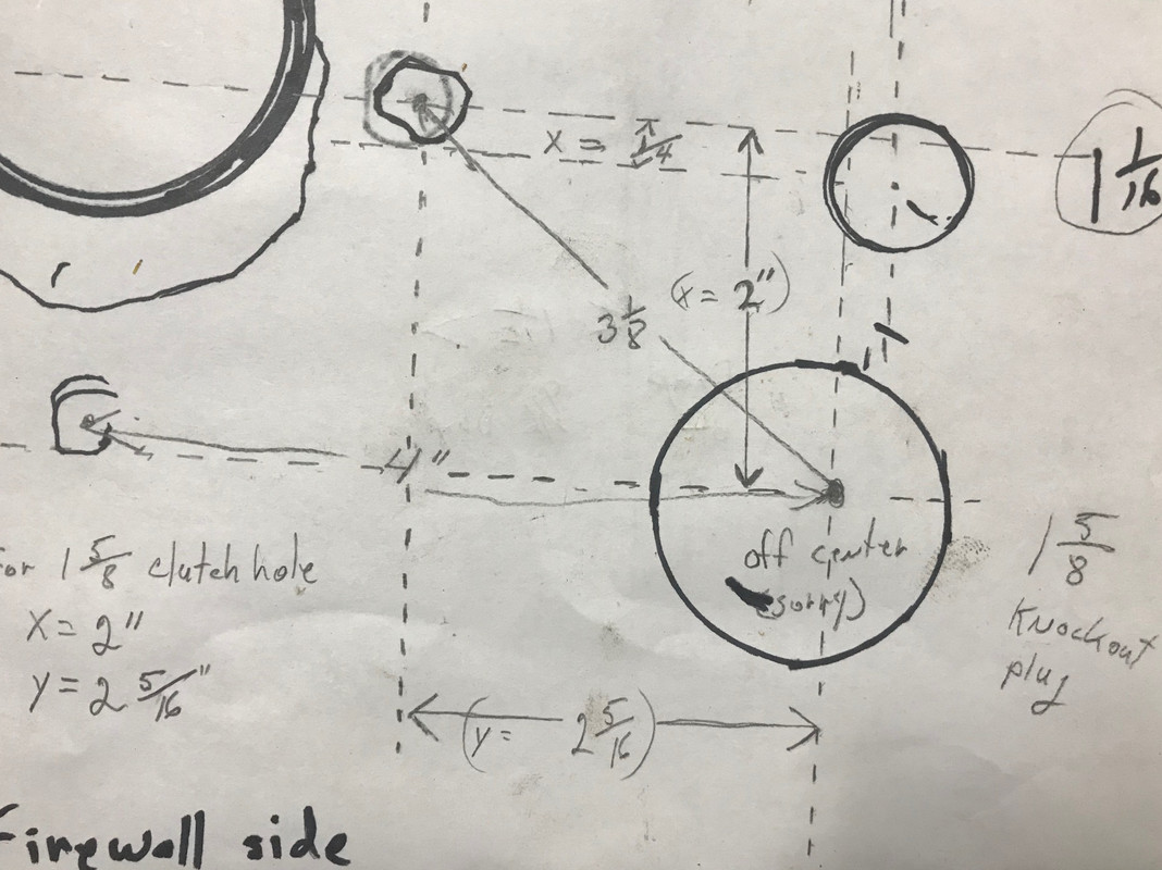

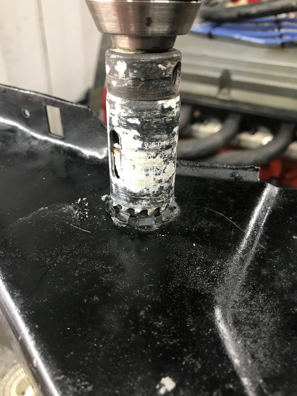

This is what the new clutch master cylinder would look like. This is a google pic and from an early GM. The problem on the early mustangs is the brake power booster takes up a lot of space. I have been working with a fabricator for Mcleoud hydraulic and he asked me to supply him some information to get this setup going for the 67 stang. Said they'd give me a break on price. I asked why don't you just do it yourself; if that's what you guys do?
Anyway, I supplied him with measurments from my firewall~ I hope it helps him!

I remember looking at that set-up when I was contemplating which way I was going to go. It's clean and simple which usually translates to effective and problem free. Just have to get the angles and travel distances correct. Also need to be sure firewall is sturdy. Stock has a fair amount of flex in it which could prove an issue if rod alignment is off too much. Good they are asking for actual dimensional info from you in engineering it. Hope it goes better than their plans for a brand newly designed transmission. I REALLY liked that one too.

I did knock out the clutch bearing installation.

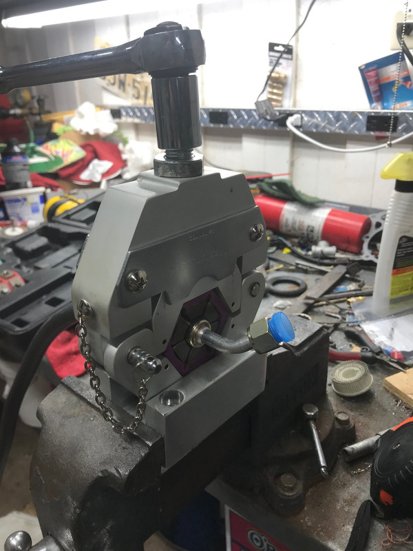

Also finished cutting and crimping the new AC lines;)

Nice work Dne'! Moving along at a really good pace honestly. The roller bearing pedal makes a really nice difference and you know it will stay that way too.
