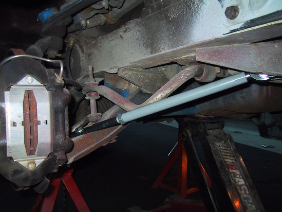

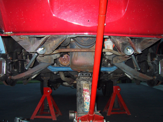

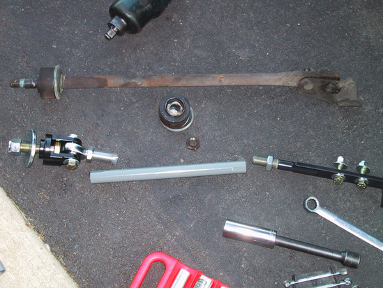

Another common issue with these front ends under load and cornering is the strut rods. the strut rod bushing gives and allows the lower control arm to move in a direction its not supposed to. Early tires did not generate the grip of modern tires - so this solution worked fine in the 60's - but today is somewhat lacking. Cheap fixerzippies in to this issue in the 80's were poly bushings. Now - better solutions are to put a link there in place of the bushing and thus make a true SLA style setup.
Shawn at Street or Track has a nice setup - and there are others out there.
Other symptoms include darting over rough asphalt w/o steering input.
Check em out. Hope this helps!

that might just be my issue. Most of the time the car feels great but there is one curve with RR tracks that really upsets the car. I can drive my truck and Taurus over the same curve and they don't care but the Mustang does not like it!
