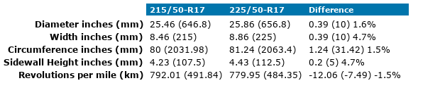

I am pondering getting 4 215/50-17 or 4 225/50-17 BFG G-Force Sport tires. Maybe run both sizes with the bigger on the back, the rears will sit just a tick higher but thats OK I guess.
A bit wider on the rears would not bother me, but I cant figure out what size that would be.
Here is a chart that shows what 215 on the front with 225 on the rears would look like number wise.
