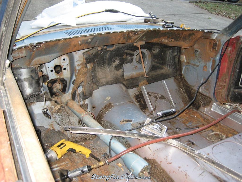

I started working on it repairing the dash and cleaning up the floorboards as well as collecting all the stuff it was missing.

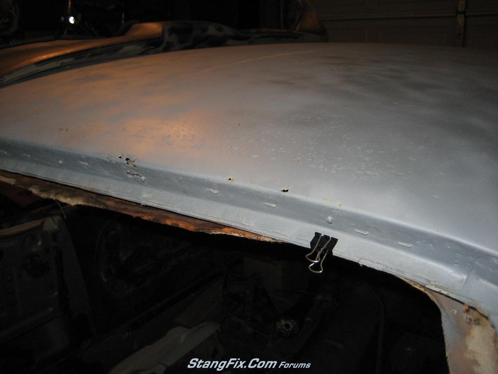

a little surgury, I stripped most of the usable parts remaining on the 68 FB. Then it was chop, cut, rebuild time! The guys at the shop cut the roof of the 68 and test fit it on the 67...
Cut the front off the 68 today. It had good shock towers. Gonna cut the dash out too
The roof is tacked on the 67
