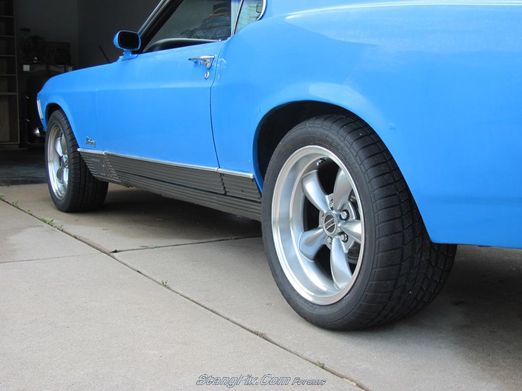

I need to drop the rear of my 70 at least three inches. Rather than putting the drop blocks under the car, was considering dearching. I called a spring shop today and they said they can do it. What do I need to know before I make a decision on this? I was reading that Rick Flores is running the 17x11 TTII wheel with the 315/35-17 tires. He said he had his springs dearched 3" and then had a 1" drop blck installed to get the ride height shown below.

Yeah it pretty much depends on what springs you currently have. If they are a 5 leaf with a higher spring rate, you'll get more of a drop with reverse eyes compared to a standard 4 leaf. Supposedly it will lower 1.5" over stock. Ideally you could use the reverse eyes and run a 1" lowering block to get you to your 2.5" drop. I'm running fairly new standard 4 leafs on mine and here is where it sits without any mods to the leafs or drop blocks (for reference):
Talked to Rick again today on both points. De-arching stock springs on his 69 pro touring car did not offset his wheel in center of wheel well, nor did it create any increased bump stop issues. He drove his car like this on the street and strip.
I figure these are stock springs and if it turns out to be wrong, I can always buy reverse eyes.
Got the springs dearched and I think I have it where I want it. I still have interior and fuel tank out. I bounced the heck out of the car and coudn't get it to bottom out. That might change with a full tank of gas. New rear ride height is right at 24 1/4. I took the wheels off the Cuda to test fit with. They are 17x11 with 7" backspacing. I may go with a different tire to add breathing room on the leafspring and wheel lip.
