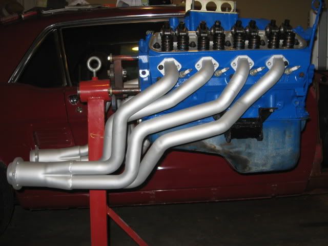

I have no idea how well it's going to work yet but since I picked up my MAC headers used for ~$50 and got them blasted for $33 I figured I'd follow suit and spray them myself with VHT exh. paint. To avoid engine break in burn off I took them to my powder coater and had him bake them in 3 heat steps as instructed on the can, last cook @600* for 30min. I won't know how it'll hold up until I finally install the motor and start it ....I know, I know. I figure I've got ~$100 into them so if I don't like them a year from now I'll sell them for what I can get and get a new factory ceramic coated set from MAC, at least it'll delay the ~$350 cost a year.
Here's a pic of them after the oven, hopefully they'll look as nice after break in:

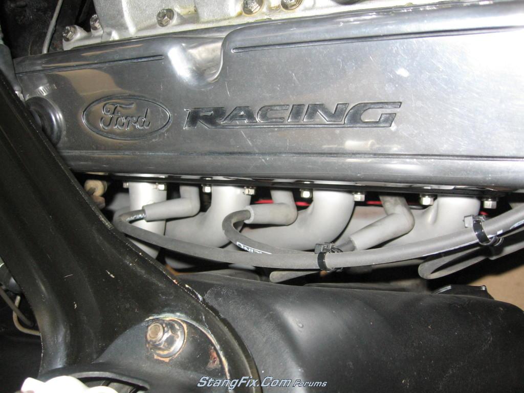

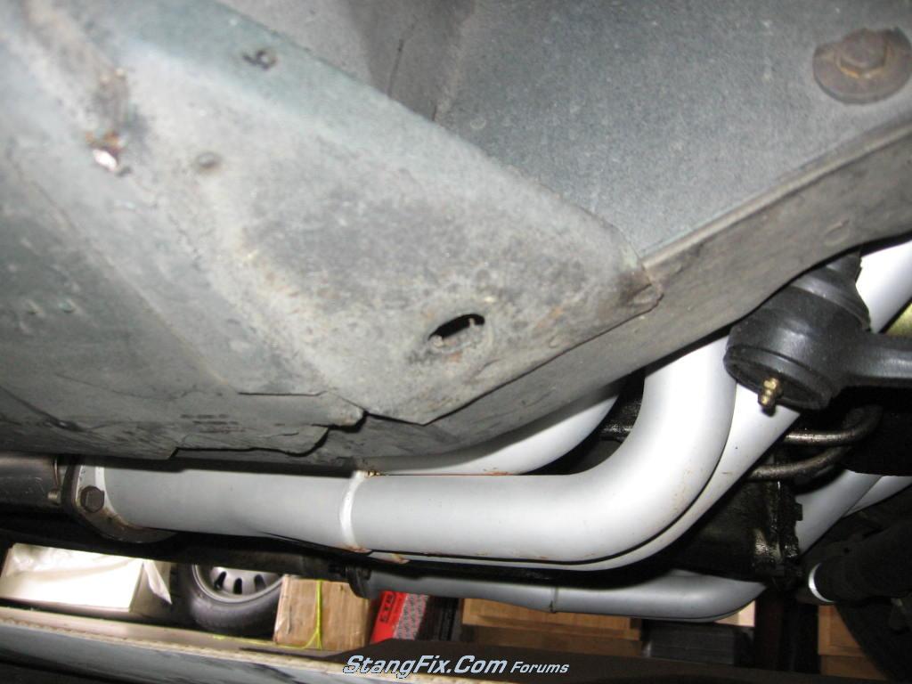

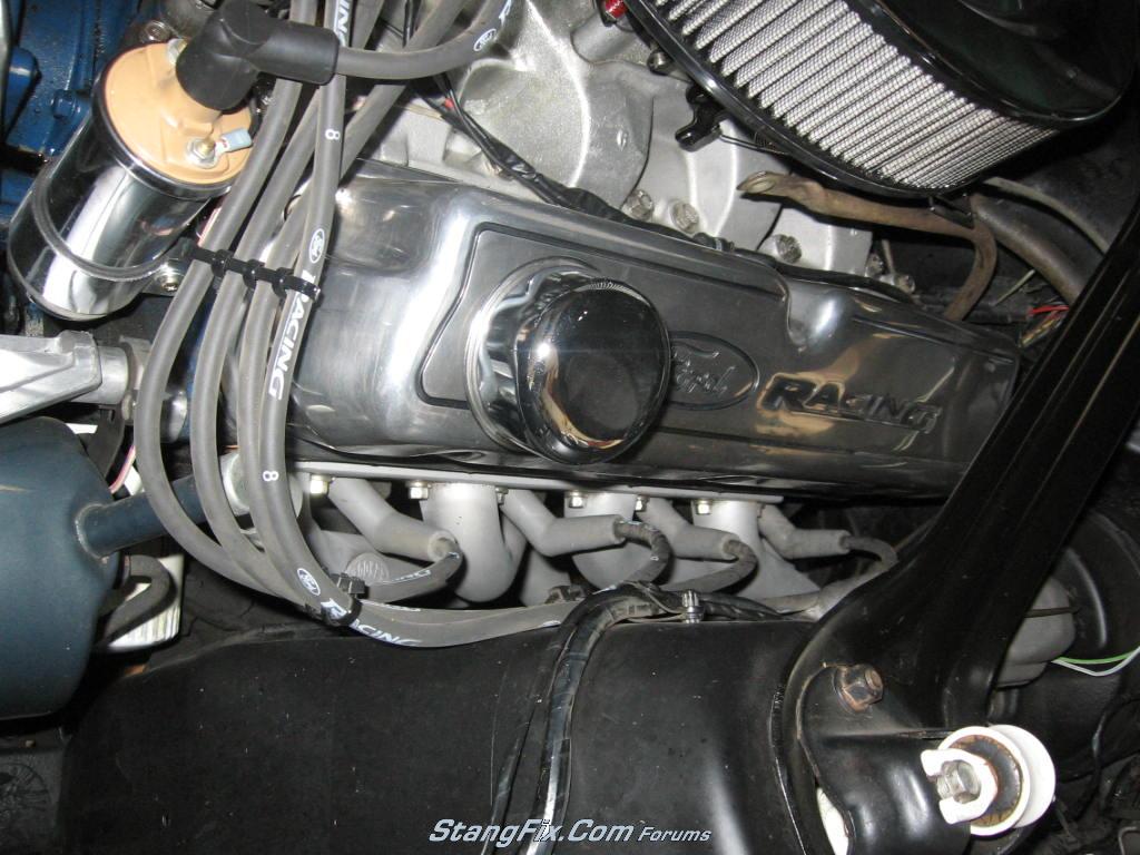

I stripped the black paint off my Hooker's with laquer thinner and spray painted them with silver barbeque paint bought from Home depot, looks like ceramic. They still look great after 5 years and I did not cure them in my oven (they would not fit anyway). I painted them in the sun so the bare metal was warm, no primer was used.
Here are some pics of the headers. It's been approx 5 years and a few thousand miles since they've been painted. I've also attached a pic of the BBQ paint I used.
