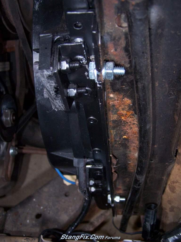

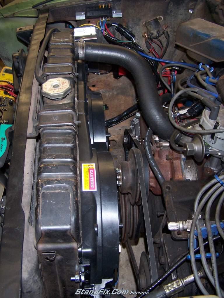

I went with the Contour fan - fits the BB radiator perfectly and move air like a hurricane. ~$120 dollars new from Rock Auto, I got mine local for slightly less. Then fabbed brackets from alum to hold it.

95-99 Countour / Mercury Mystique. Has two fans offset, so it helps with the depth issue (none of the fan motors are in the way of the water pump pulley. Pulls a massive amount of air, each fan pulls 17 amps when running. Here's a diagram I found when I was deciding which way to go. There are a couple of tabs on it that don't show on the diagram, I used them to help mount it (shown in the pics above). Some folks have just used the plastic ties used with aftermarket trans coolers & fans (that go through the rad.), but I felt better with the hard mounted brackets.

17 amps hu? Hummm, the Spal fan I using now is the Extreme Duty 16" #2807016-VUR rated at 3000 CFM. It is super loud.
How load is the Countour fans?
Not too loud, about the same as most new cars' fans. I have a 2800 cfm Derale on my truck, and they aren't much different than that. Engine running and radio on, you can hear it, but it's not distracting. IME, the OEM design fans are quieter than aftermarket for the air they move.
