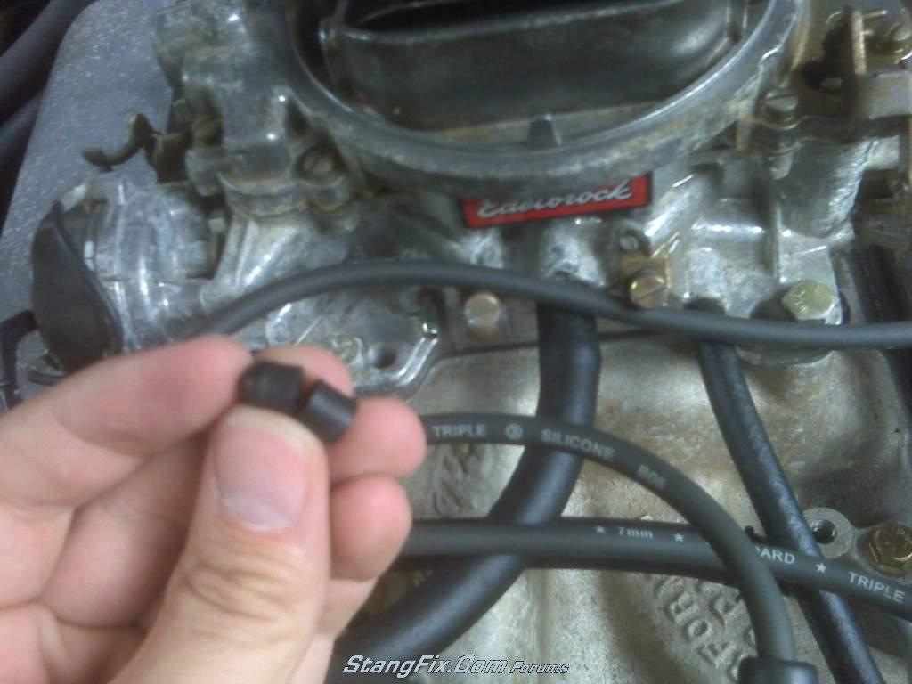

I'm pretty sure I had a bad vacuum leak since the cap on the timed port was cracked and fell apart when I took it off:

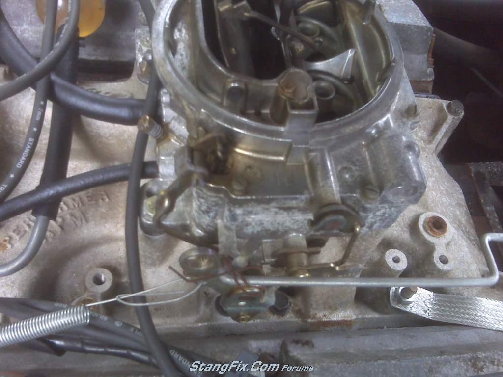

Also, the area around the plunger (don't know if that is what it is called) on the carb seems to be discolored and after sitting all night looks like there might be trace amounts of fuel leaking around it. Does that make sense? Is it even possible? Here is a bad picture:

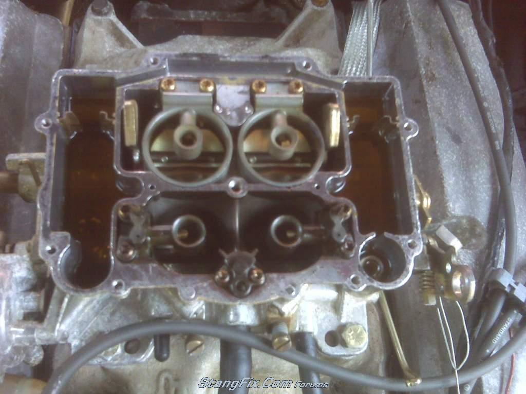

Then I removed the tiny little clips holding the various rods onto cams (choke and pump) and of course *ping*... there goes one of them, lost in the driveway forever. Gotta find some replacement somewhere. The inside of the carb didn't look to bad to me, but I don't really know what I'm looking for. The gas did seem a little yellow which I think is not a good sign.

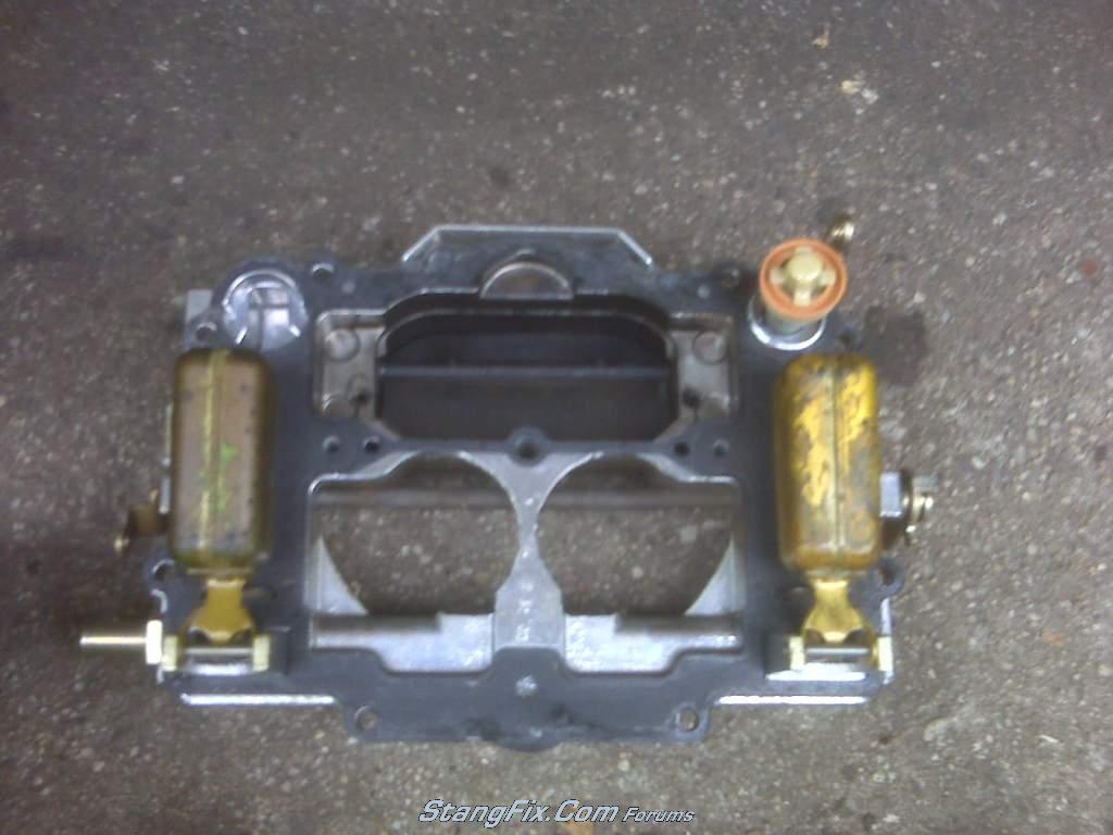

I sprayed everything with carb cleaner then attacked the airhorn.The floats looked dirty but the needles looked clean. I shot some carb cleaner in seats anyway just to make sure there was nothing in there.
before cleaning:
Everything got reassembled, jumper cables hooked up and the requisite extra shot of gas down the carb. Turn the key and she fired right up then stumbled a little and seemed on the verge of death. i bumped the gas and it suddenly smoothed out a bit and held an idle. I was able to get out, disconnect the cables and run the car up and down the driveway for a few minutes with no troubles at all. I think the moral of the story is I need to run this thing more often so it doesn't get all nasty inside. The real moral is I need to get this car drivable so I am more motivated to tinker on it. Also I need to look into a smaller carb because I really have no need for 750 CFMs on a 5.0.
