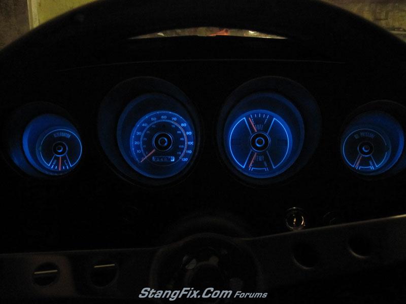

Well I installed l.e.ds in my stock gauge cluster they work great and so do the turn signals but after putting everything back together I realized gauges don't work.. Now I had to take the gauge cluster apart to remove the blue covers behind the gauges.. I left out the paper gaskets that seat the gauge into the cluster, did that by accident.. Would that cause the gauges not to work or is it the circuit board that partly went bad ? Im totally lost on this one and mad as hell for not checking before putting everything back together lol dam me!!! :roul

Yes, I got the 5x set. They don't dim though, as far as I can tell.
Doesn't really bother me because I like them full on anyway... the dash lights were so dim before, they were pretty useless at night. Much better now, & not harsh on the eyes at all IMO.
