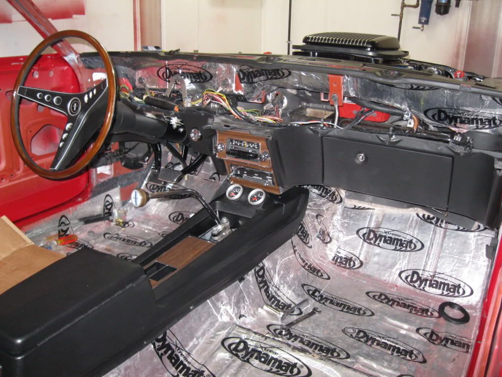

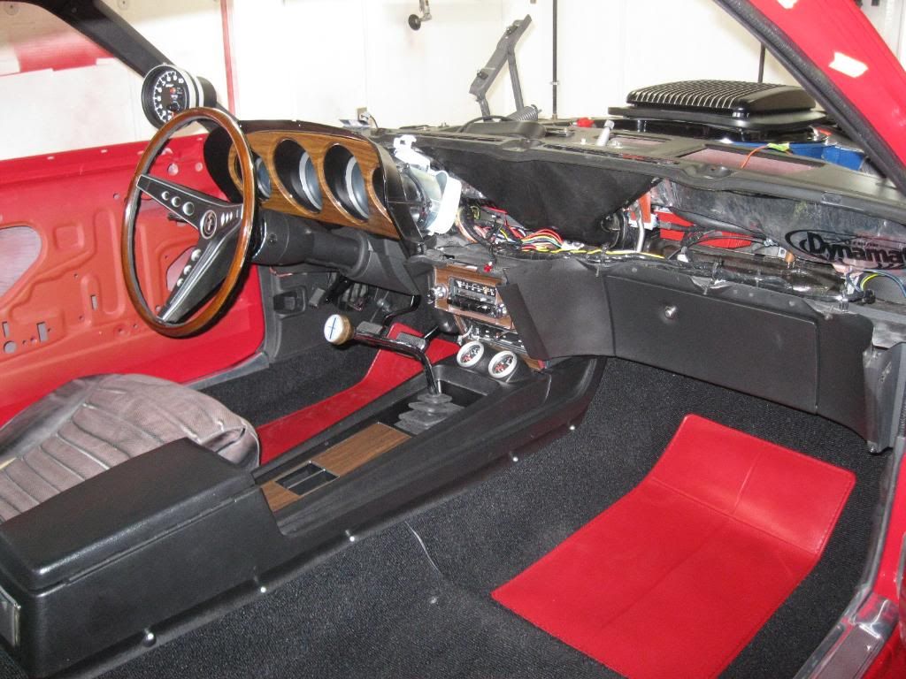

Regarding the bracket, the picture below may help. If you have any questions let me know. I've had these dashes removed and installed many times and know it pretty well.
Install brake pedal support to firewall, heater box (or A/C box if equipped), attach brake pedal to M/C and clutch pedal if equipped (can be done later but access is easier now), install cowl vents (can be done after but easier to access with dash removed), install parking brake assembly, make sure wire harness is clipped in good to the lower dash with all connections hooked up for items already in lower dash (heater, heater light, turn signal and hazard cans, wiper switch, headlight switch, etc), then install lower dash assembly. There should be braces above lower dash at steering column that bolt to cowl/body, as well as a brace on passenger side near clock. There are L brackets at end of lower dash that bolt lower dash to body at each end. Adjustments may be needed for fitment, both at this time and when you install top dash pad. Once lower dash is all bolted up, finish hooking up wire connectors to heater/ac, firewall and engine bay, etc. Install instrument cluster to dash (parts of it are shown in your pics 4 & 5 above), then attach clock panel to top dash pad and install dash pad to lower dash (adjust lower dash location via end brackets as needed). Finally, install the end caps (end caps are what you show in your 3rd pic) and caps near heater/radio, bolt up steering column and install steering column trim and collar. Make final wiring connections. Off the top of my head that is the process I have followed. There are a ton of pictures in various states of assembly if you google "69 mustang dash" and choose Images. An assembly manual would also save you some headache
I would mention that those vents on either side, that go behind the kick panels, need to be installed before the heater box and before the parking brake assembly.
I had my vert torn down to the level that Buckeyedemon's top photo depicts, sans Dynamat. Even though I took it apart I was sort of intimidated and kind of despairing of ever getting it back together after I had it all torn down. It actually went back together without any serious hitches. Not even any over and short screws.:)
