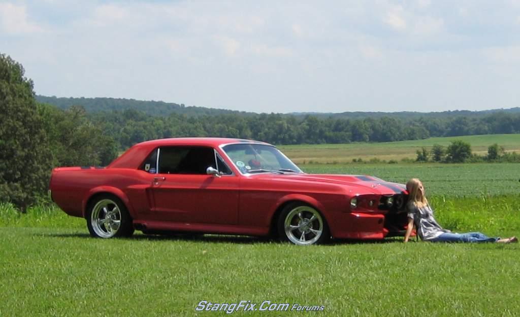

Man, ride height is one of my fovorite things to work on. It makes the car IMO. I'll work and work to get 1/4" of ride height change. When I get the car done, I park it on a flat surface, walk away from it about 40ft and turn around. My first thought is what I got with. I've done the rear springs on my 66 coup 4 times and it's still not right. I worked on the Mule for over a year redoing the rear springs to get it right. I love it best becouse it's a free mod. We do the 1" upper arm drop to everything we own exept the cars I won't drill holes into. We run our 480lb GT spring on the early cars and our 560lb spring on the later cars. I've never bought leaf springs for any of our cars. I do dumpster diving at the restoration shops and get the ones they toss out to make my own leaf pack. More on that below.
...........65-66 620 1" drop coil ........ 67-73 620 1" drop coil ........ Stock coil 67-73...........
The 620 springs are a 560lb spring. If you put them on a test machine, they come out between 560lb and 575lb. That's why we call them a 560 on our web site.
I can spend as much time getting the ride height the way I want as it does to change motors. The front is pretty much just cutting coils but that can take a lot of time if you cut 1/8 to 1/4 coil at a time. I've learned how to coils while they are still in the car, that saves a lot of time.
The rear is a lot harder. I don't use lowering blocks ever. I rebuild leaf springs to get the ride height and spring rate I want. Here is some info on that. ( http://www.stangnet.com/mustang-forums/544275-lowering-rear-car-w-o-blocks-long.html ).
Getting the tires to fit right is another story. The backspacing has to be right and the fender lip has to be removed or rolled to get the look I like. A wheel with 4.25" of backspacing fits with no mods to the upper arm. If you grind on the ball joint dome a bit, you can use a wheel with 4.50" of backspacing. On my next project I'm using a wheel with 4.75" of backspacing. The ball joint dome is cut back and braced, looks like this.
