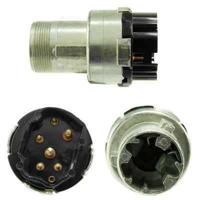

also to answer one of your questions, about the ignition switch, the dash will have a notch in a cup like thing and the switch a raised "boss". This is what keeps the switch from spinning. Switch pictured below, you can see the raised boss in the casting on the threaded end. In the second and third pictures you can see the cup like thing inside the hole on the dash where the switch goes. If yours is broken they are reproduced.
