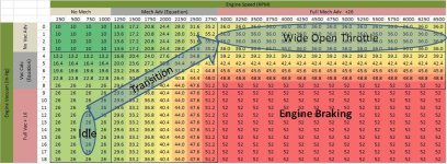

I just did a write-up on the distributor that I chose to go with more my upcoming 331. I tried to really get into the tech behind the dial adjustable advance curves. Hopefully it can help someone else out.

A few teaser pics of what's inside:

Good info., I skimmed through the adv. curve article, I'm going to have to reread a few times in complete silence to catch on. This will be handy when I make my ignition choice for my 331. I'm already leaning towards the Crane just from comparing their units in hand at a Summit loction. I think Summit uses their boxes as the base for their box too.
