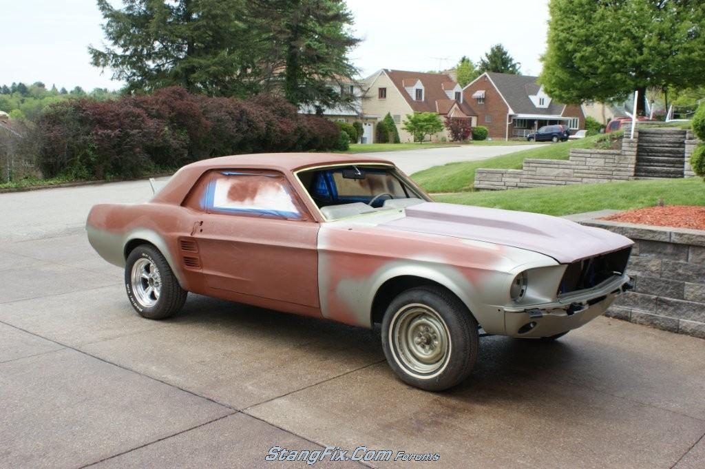

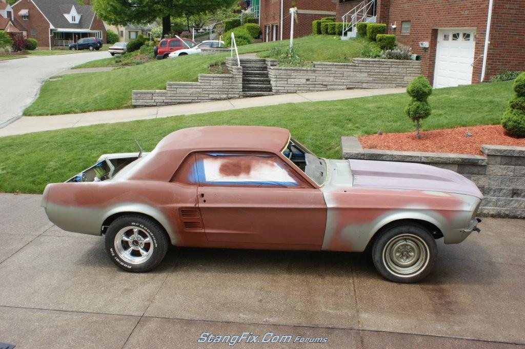

I brought my car home in may of 2008. Prior to me owning it, it had been stored in a garage for 13 years uninspected, and not running. After a solid tune - up and fluid change, new battery, solenoid, and coil, I rebuilt the carb :lol, replaced the distributor, and it fired up. The motor was original, and just over 100k but would burn oil pretty bad.
The day i brought it home:
Its amazing what a new set of wheels and a buff will do for a ride!

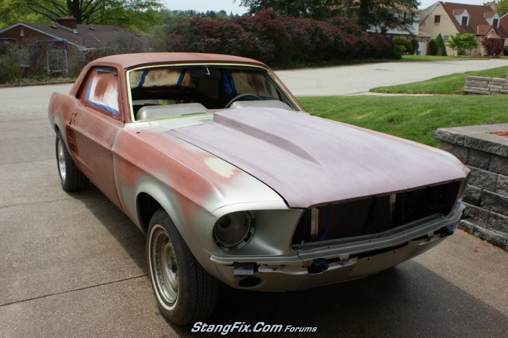

Now for the Hood
After exhausting all avenues to try and find a steel hood with a cowl scoop, i've decided to make my own.
Its a repop 67 Plain hood and a 2.5" Scoop from Goodmark Industries.
The plan was to change the rear taper of the scoop a little.
In order for the hood scoop to sit down on the hood, some relief cuts needed to be made.
The hood prepped for welding and then welded.
The hole needed cut.
Some body work, and the Seam feathered out. I got pretty lucky and had no real warping issues to deal with.
Put to a guide coat.
