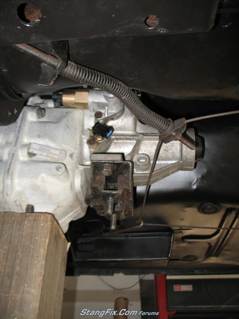

I'm in the middle of mocking up the T56 and came to the realization that the stock location of the parking brake cable and brackets is definitely NOT going to work Not only is the bracketry attached to the front frame rails in the way of a transmission crossmember, but since the motor is lowered and moved toward the rear the cable that crosses the trans tunnel is touching the tailshaft of the transmission. That will rub through the cable quickly.

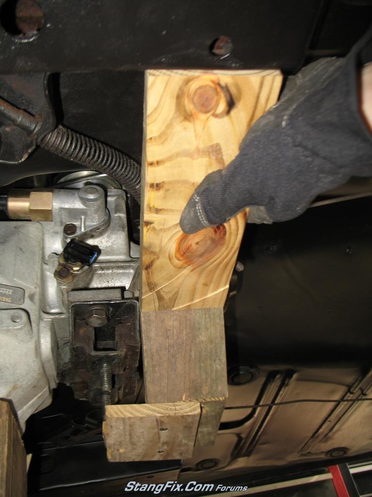

Thanks Dave. See below for pics that may clarify. As you can see the end of the stock front cable and spring as well as the hook on the passenger side are right in the way for any kind of transmission crossmember. As stated before, you can kinda see the cable touching the tailshaft of the trans when it crosses over. I'm also dealing with the Magnaflow 2.5" X-Pipe with crosses at the front U-joint, so clearances are becoming a pain when it comes to a crossmember. If I can remove/relocate the parking brake stuff it would make fabricating the crossmember MUCH easier. The second pic is the start of my wood crossmember just to get the angles right and check clearances, to give you an idea of placement.
Ideally I would like to get the stock front cable into the trans tunnel and then route the Lokar cables in the tunnel. I don't think the stock cable will reach to the tunnel though without some extremely tight bends, which would likely cause binding issues. The other thought I had was to fab a bracket and place it on the outside of the front frame extension and run it down the floorpans near the rocker, but with plans of Tinman subframe connectors it may be tough trying to get the passenger cable around the connectors. Just throwing out various ideas that I've had, none of which seems to work :sad

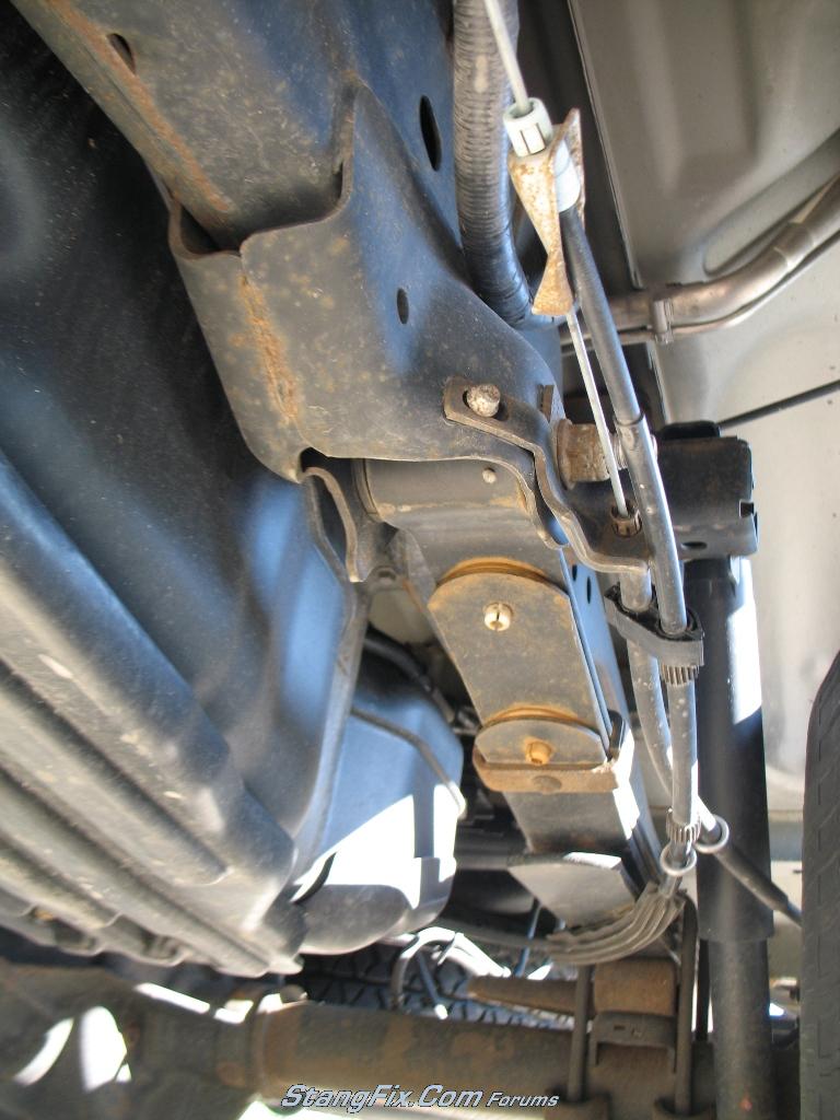

I just had a light bulb come on. My 2005 F150 has a foot operated parking brake, so why wouldn't I see what Ford did with it? Below are pictures of the front part where it comes through the floor and runs alongside the outer face of the drivers frame rail, then a pic showing the rear cables.
It's got me thinking, I wonder if I couldn't mimic this setup or even buy the F150 cables from a junk yard and see if I can't cut them to fit? Below is a pic of the underside of my car, just picture the rectangular tube subframe connectors. Since the subframe connectors hang down below the rear frame rails, I could cross the one line over at the end of the connector. Otherwise I'd have to deal with the leave springs similar to what was done on the F150

Looks like you've got some extension left on the drivers side and its longer right now than the pass. solid 'J' hook, is there a way to either fab a longer 'J' hook for the pass. side or make a new hole to move it back 1-2"? It looks like you only need and inch or 2 back and you'd clear the angled webbing under the trans. You may need to shorten the cable or put a small loop in it with a crimp clamp like used with woven cabling to take up some of the slack. These options might be eaier than rethinking the whole system. Not at home at the moment and don't have my links available.
Jon
You bring up a good point actually. Regardless of what I do with the brackets in their current location it will interfere with the crossmember. I could investigate relocating both brackets further back on the frame rails. This would mean that my cable would be too long, but I could always shorten the cable and fabricate a junction block since the modified original cable wouldn't have the "ball end". Good thoughts!
