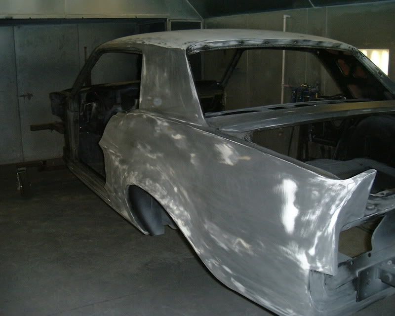

    I've had this car for about 5 years working on it a little than it would sit a long time and than work on it again a little and than sit untouched for a long time. Over the 5 years I have changed my mind a few times on what modifications I will be doing. We did all the rust repair new floor pans, one torque box and the trunk floor in 2006. I flared the fenders and rear quarters using metal. It is hard to find the time to work on your own when you have customer cars to restore. It will take me a while to get you up to date. I want to get this finished so I can have something to take to cruise nights and car shows. If things go right it will be running this year (2011).
    Here it is before we started
    [​IMG]
    [​IMG]
    Cut out the rusted floor pans and replaced
    [​IMG]
    [​IMG]
    I added about 1 1/4" to the fender flare
    [​IMG]
    [​IMG]
    [​IMG]
    [​IMG]

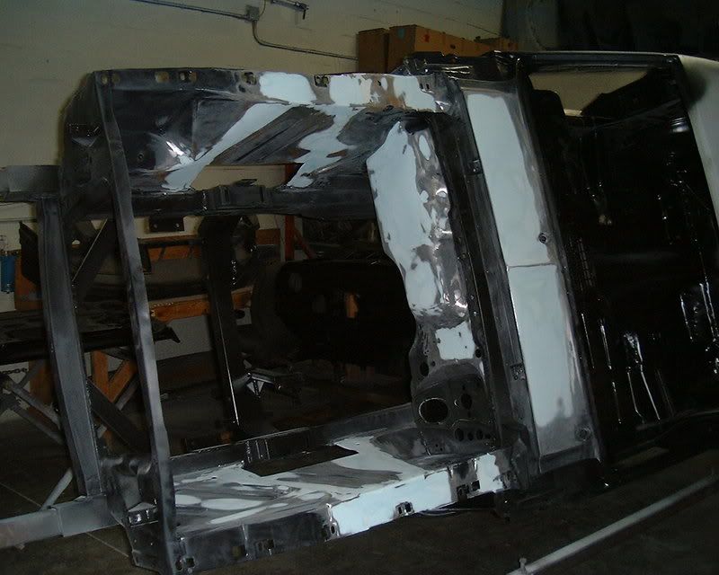

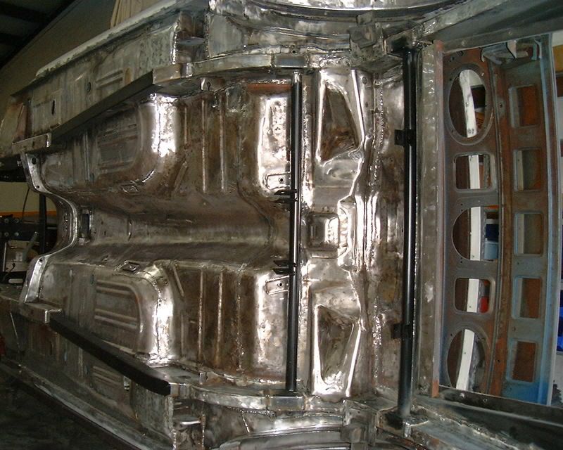

    We stripped all paint and undercoat off and welded up all the seams
    [​IMG]
    Subframe connectors and Rod & Custom Motorsports rear crossmembers welded in
    [​IMG]
    Test fitting the rear suspension so the rear sway bar brackets can be welded in. Found out the sway bar was to long.
    This was their second kit that I've had for awhile and they now have a 2" shorter sway bar which they sent me.
    The Mustang was sprayed with SPI black epoxy
    [​IMG]
    [​IMG]
    We have finished the bottom of the body and sprayed it with SPI bedliner.
    [​IMG]
    [​IMG]

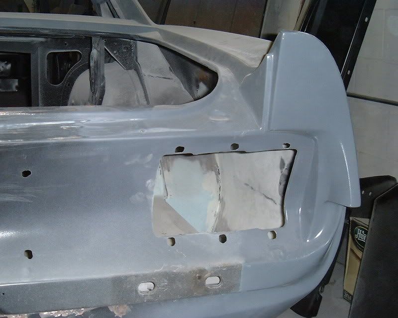

    I changed my mind on the taillights. I was going to put a deluxe ribbed taillight panel in and I had cut out the original taillights. Now I have decided to french them in instead. I had put a reproduction taillight panel in our Eleanor project and cut out the original taillight mounting area.
    [​IMG]
    The reproduction taillight mounting area was about 1/4" to big so Brian cut it down and welded studs on it.
    [​IMG]
    Brian welded it back in and now has to grind the welds.
    [​IMG]
    I finished the major bodywork on the taillight panel it still needs to be block sanded and I need new taillights.
    [​IMG]
    [​IMG]
    [​IMG]

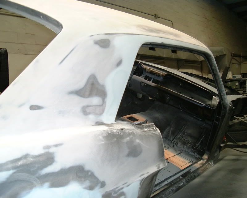

    I decided to do away with the drip rails even though they were in good shape. Brian used a cut off wheel than welded it back together and than I started doing the body work.
    [​IMG]
    [​IMG]
    Sprayed a coat of SPI black epoxy
    [​IMG]
    Next a couple coats of Slick Sand polyester primer
    [​IMG]
    After a lot of block sanding
    [​IMG]
    More primer this time I used SPI Turbo urethane
    [​IMG]
