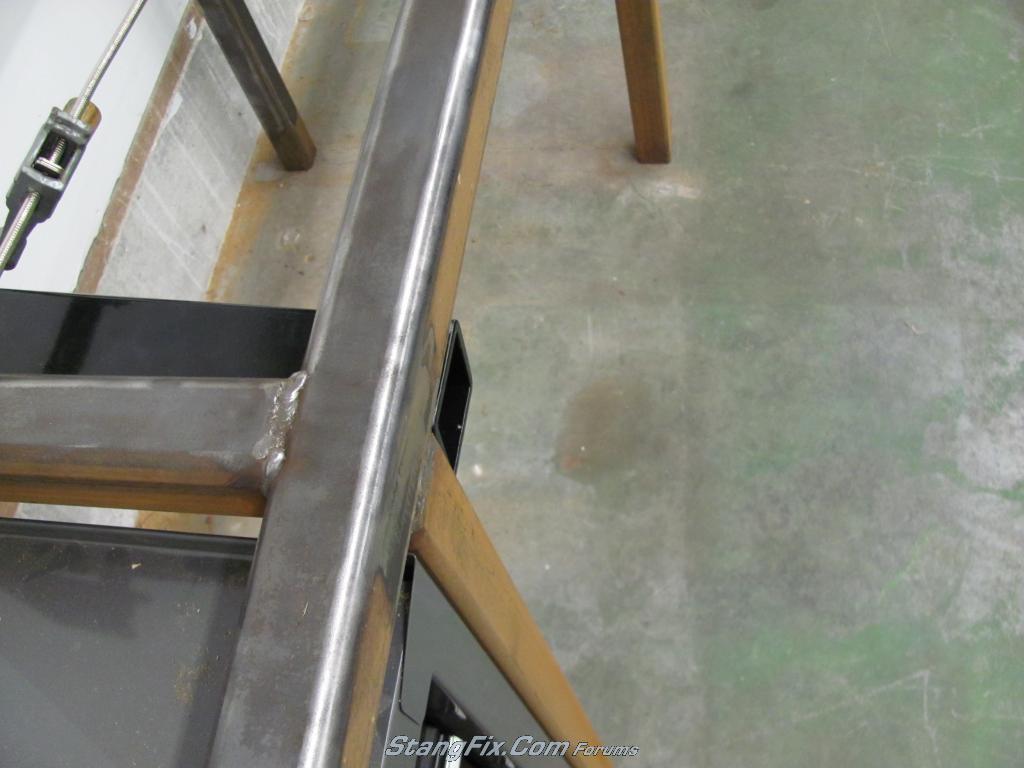

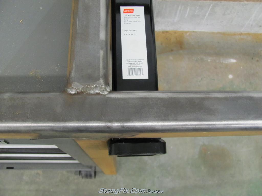

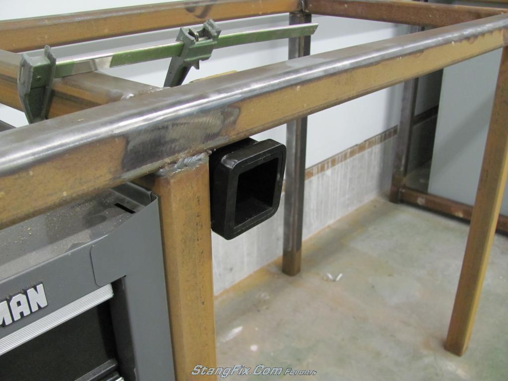

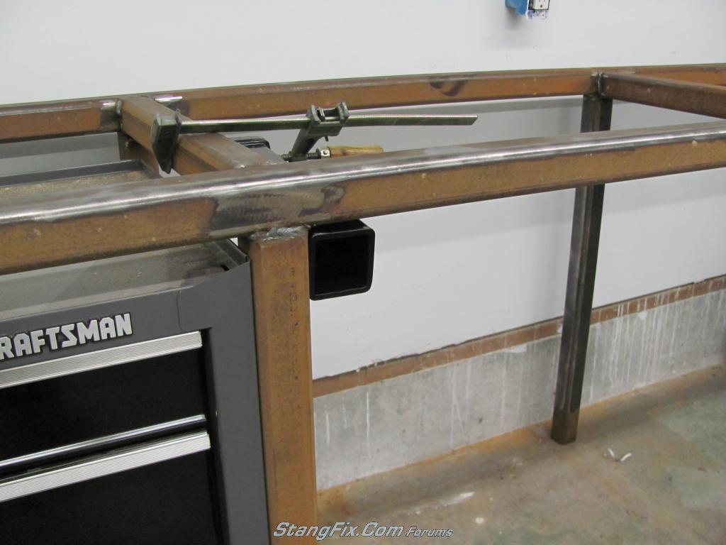

I do need some input though. I'm planning on using the receiver hitches at the upper corners of the open stool area to hold bench vise, bench grinder, etc. Which way would you have the tubes, with the welded ring hanging out past the bench (back of ring welded to upper bench tube, so it'd be pushed back as far as it'll go), or would you flip it around so that there is no ring and just weld it flush?? Below are a few pics of the two options. They are incorrectly placed at an angle due to clamping issues I had. Picture them not at an angle
Ring exposed:
No ring:
Put them flush.....but.....those units have play under normal applications. That can be a issue using a grinder mounted that way unless you do a better fit on them.
Pete, I was planning on welding a nut on the pin hole and use a threaded handle. I've though about putting one on the side as well as the bottom, to provide clamping on each axis. This provides a tight fit for when it is needed.
Hmm, I didn't think about the top overhanging. Shouldn't really matter though as my accessory hitch stuff will not have set depths to be installed in the receiver.
the top overhanging, specifically if its steel, or stainless steel, allows for a thin sturdy clamping surface when working on projects.
Yeah i was planning on the top overhang, I just didn't think about having the "ring" hid underneath the top due to that overhang.
I might look into getting 2.5" DOM square tubing with 1/4" walls and see if that provides a tighter fit, before welding these things on.
