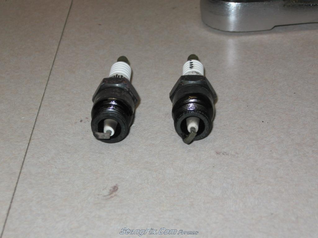

Here's a pic, #1 plug on the right, #5 plug on the left, Autolite 45, they are about 1 year old. The last time I pulled them, the insulator was fairly white. There is soot on the inside ends of the tailpipes.
so I would still have to agree that fuel is getting into the engine from somewhere other than the idle circuit. The plugs don't look "wet" but it does look rich. They should be more brownish white and the tail pipes shouldn't have too much soot. Some is typical with a carb.
