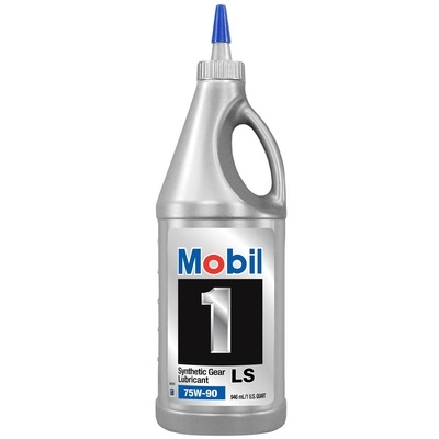

In case I end up just pulling off the 3rd member, Do you know how much fluid I would use to refill it? What is a good fluid to put in it as well?
"Larry G" said:
Craig do you really mean pints?
yeah, did I spell it wrong?
I usually use 2.5 to 3 pints of 90W in an 8 inch rear diff. I fill it till it runs out the fill plug.
