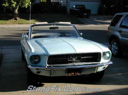

After owning the car for more than five years, I'm making a commitment to getting the car back into driving shape and, ultimately, restored to a great show shape. The loose fit goal is to have it driveable and reliable and fairly cleaned up for Knotts in April '12 and to have it painted with bodywork done and more or less completely finished by Hot August Nights in August '12. We'll have to see what happens.
These pics are from when I bought the car in June '06:
Overall, it was in pretty good driving shape when I bought it. Arcadian Blue (
uk ...sorry, my opinion) with a parchment interior and a white top. My long term choice is to keep the parchment interior but change the color to Brittany Blue. I'm also considering a bit of a GT Clone look with GT exhaust, striping, and fog lamps.
The 302 4V was rebuilt about 20k miles ago. Running into a C4. Nothing really special there. The main engine mods are a slight cam increase (like the Edelbrock 2121/2122 combo) with the Edelbrock 1406 carb. Dual exhuast set up with Dynomax Super Turbos and 2 1/2" pipe. The main mods I made to it within the first year were a complete suspension rebuild, spec'd by our buddy Opentracker :thu. Mideye leafs in rear with GR2 (gray) shocks. In the front, there's an arning drop, 620 springs, roller perches, new upper and lower arms and thrust rods. Front brakes converted to '70 Mustang discs along with a power master cylinder.
