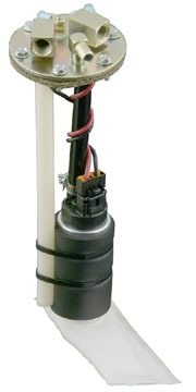

I plan on going this route with the tank
