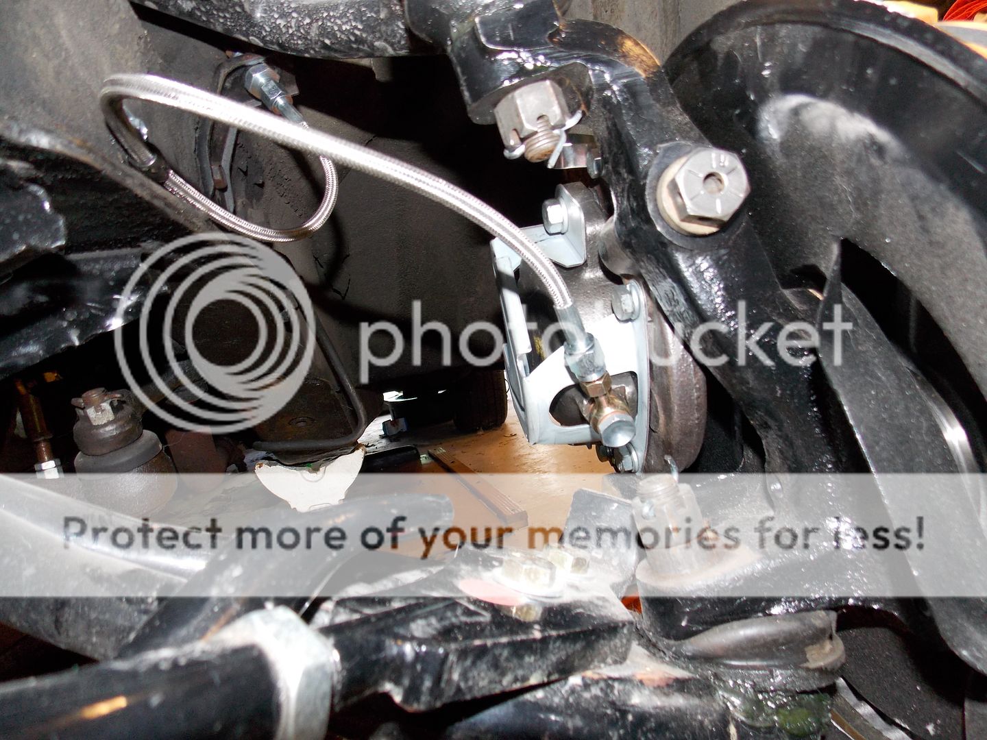

I used DOT legal flexible SS brake line from Speedway and fittings.
