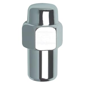

Sure you got the correct lug nuts? I thought those wheels took the type with a shank about an inch long or so. This also centers the wheel.

It's such a tight fit, I can't really see where it touches, but I can hear it. Maybe I do need those type of lug nuts. He said I might have to change them depending what I had.

Get the lugs checked out first. If the hole in the wheel has a straight sided hole and flat at the surface the lug goes against, you need new ones like I pictured. You can take the wheels to a local tire shop and most likely find the lugs. For that, I like the private shops vs the chain type.
