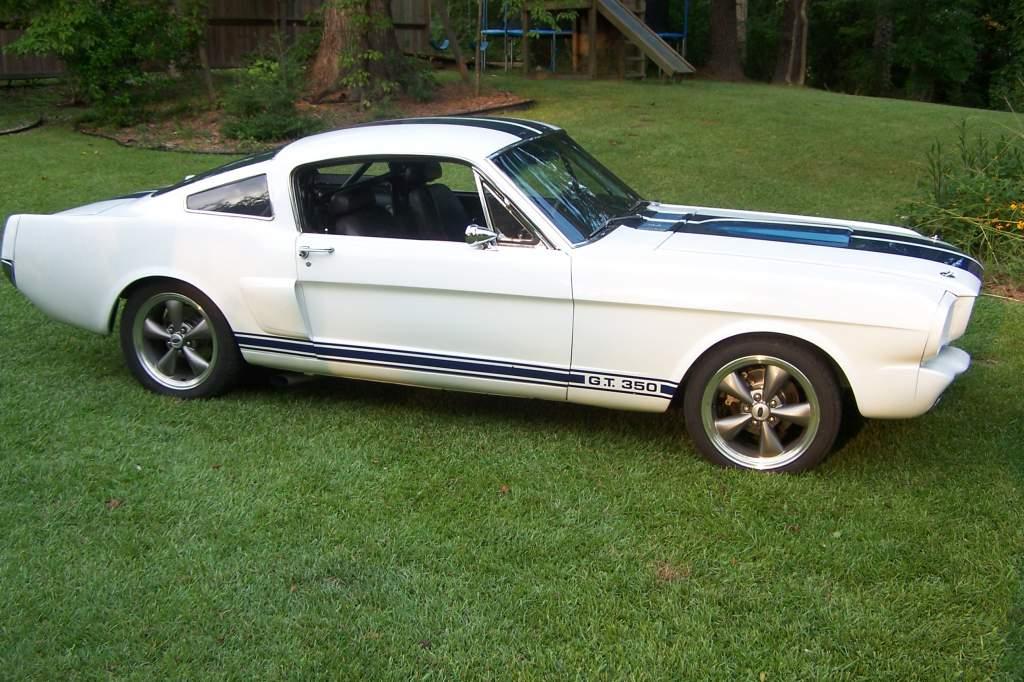

I have the opportunity to get a set of 17x8 rims with 245-50 tire for dirt. The wheels I believe are off a newer cobra, they look like the torque thrust rims. I took a quick pic of it setting next to the fender. The rims are in descent shape -- two are flawless, but two have a bit of curb rash on 'em. The rims looks horrid in the pix thanks to the crappy camera on my blackberry...:

I've got similar, if not the same wheels on my '66.
I had to use 1" wheel adapters on the front.
My rearend is narrowed (one inch each side), which required me to use 2" adapters.
The 245-50 tire will likely be too large for your front wheelwell, but will fit fine in the rear.

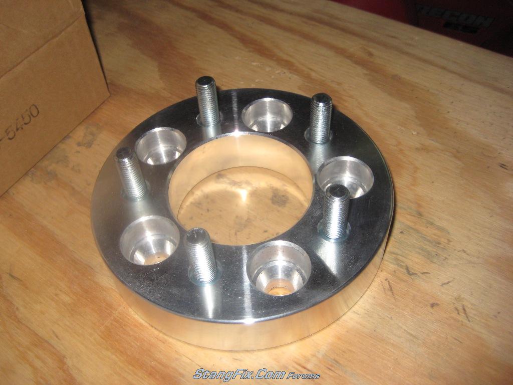

From my times working at a tire shop, what you have were adapters, same lug pattern or a different one, the attached pics is what we found as spacers. I never liked the spacers due to balance issues and most people do not install longer lugs.
