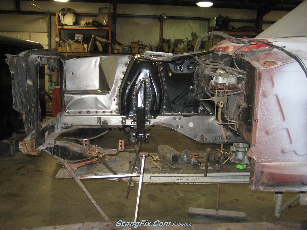

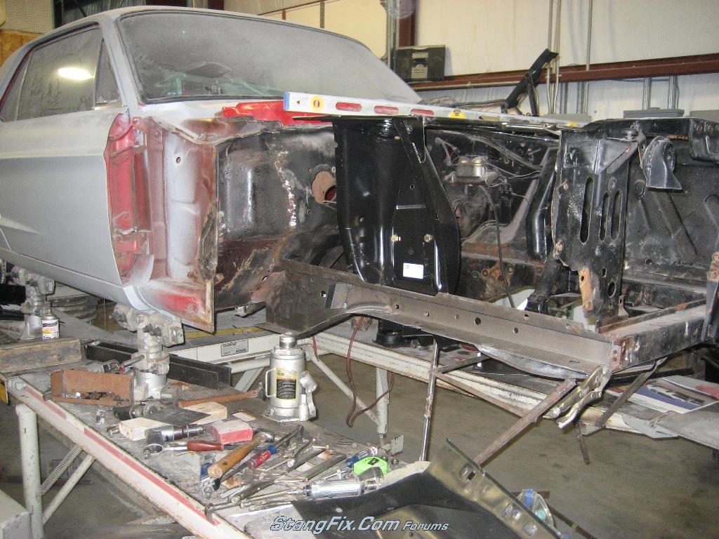

Your heart is in the right place questioning the use of overseas parts. Unfortunately that is the reality of this hobby. A significant percentage of parts are made overseas, and heck, the new Dynacorn bodies that are out, are 100% made overseas. Well, the metal is anyhow, the unibody may be welded up here in the US.
Looking at the pictures above of terafied's frame and shock tower work, there are now options to buy all of that as one solid piece, it comes with the frame rail, shock tower, and both aprons already welded together. This reduces some of your alignment and measuring issues. Same with the back of the car, there are a bunch of sub-assemblies like the complete floor pan and rockers, frame rails, complete truck floor, etc.
