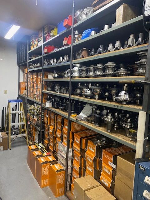

The open 3.00 rear end on my Mach 1 is badly worn, doesn't whine but lots of play.
I want to change to a 3.50 Trac loc type.
Being in the UK I pretty much have to buy from the US and if I buy the parts then i have to pay for someone to build / set the gears so I'm looking at a complete 3rd member.
The shipping and import tax can be $300 / 600 so I need to make sure it's a good buy.
Any suggestions on make / company etc the pictures are one I found on e-bay that had cheap shipping, sometimes its 4 times the amount and I end up paying import tax on that as well.
I'm assuming all open 3.00 diffs were 28 spline ones and is there any way I can check without having to pull a half shaft out as I want to leave it driveable until I'm ready to change it.
Cheers
I use Quick Performance for all my rear end stuff. Shut up {.}. They can build a stock unit up to something that can handle thousands of ft/lbs of torque and everything in between. If you watch any of the TV performance shows or Youtube guys you'll see their name come up all the time not too mention their sticker/logo plastered on race cars in every type of racing. I can't imagine you would have any trouble with something they put together but if you did I would expect them to handle it professionally and to your satisfaction more than some random seller on E-Bay.
I run a full rear end built by them in my mustang. Tru-Trac unit which I think is far superior to the original style from Ford.
And yes, if a stock rear end it should be 28 spline.

Thanks for that, but also is if there is a problem the US is a long way away and even more shipping!

I've looked at their web site, I like the fact you can "build" your rear end.
Never having touched a diff before can you explain the "pinion support and yoke" options and what I'm likely to need for my 9", it wont ever have big HP going through it I'm sure.
You just need stock style Ford 9" stuff and as far as needing a specialty pinion support, not necessary. There are a variety of different yokes for 9" rears and the bigger the number the "beefier" it gets. Really just in terms of u-joint size. Here's a good video explaining the three main sizes and how to tell them apart. Just measure what you have now and order the same.
There are also longer and shorter, wider and narrower versions of many of these. You need to make sure the length of the new yoke is the same as the current one or your driveshaft could come up too short to long. There are plenty of sources on the internet to help you determine if you have one of the less common longer pieces.
Hoserplay is correct. QP does make quality parts. Just know they are WAYYYYYY behind because of all the covid orders. It's been 10 weeks and I still don't have my new chunk.
I used this company for my 8" Tru Trac 3.55. TJ Rebert was the former owner who passed away and Alex Von Ahnen (I believe he was an employee) took over ownership. I believe he is on ebay but you use to get better pricing by directly contacting him. Haven't had issue one since my install 4 years ago. Hope this helps.

I've just ordered a 3.50 trac loc from Alan at 8/9" rears.
His price for a complete pumpkin delivered to me in the UK and after I've paid import duty etc is still about $100 less than a UK company wanted to "rebuild my casing" to the same spec so I get to keep a spare working diff.
