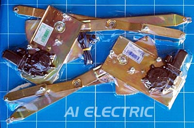

From what I recall the Autoloc switches interfer with the A1 Electric regulators. Their shaft is in the center of the switch block.
