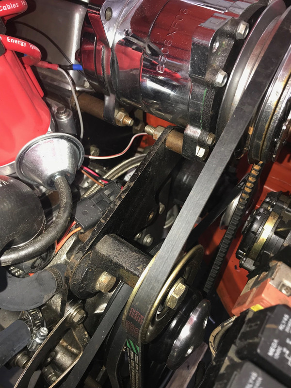

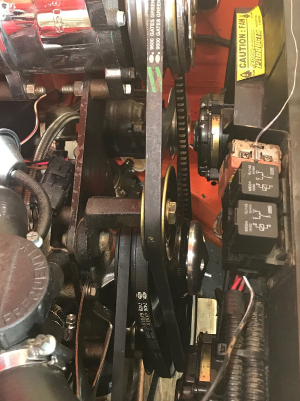

With the pulley set up (v band). I have seen three belt set up and two belt set up. Is the two belt set up okay?
That looks like a good setup! Mine setup is from about 2009-10, so it's changed a bit, or a lot. I just looked, mine has 3 grooves on the harmonic balancer, but the pic you put looks like it gets away with the 2 groove type. I would say the 2v type is fine. I like that setup you posted as it allows access to the water pump without having to remove everything.
