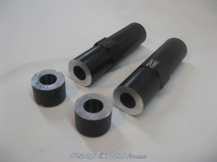

Finally took these in to the machine shop to be shortened. They turned them down on a lathe, 1 inch removed from the inner tie rod side (as instructed.)
