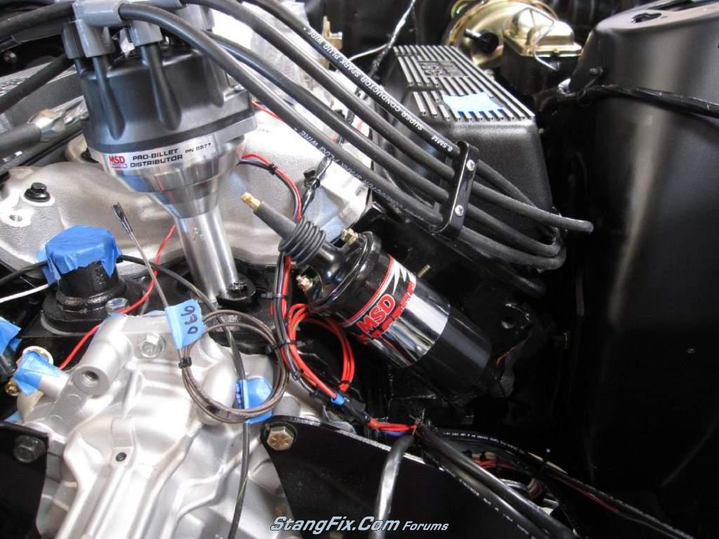

Here's a couple shot of my coil location. The problem I see with the first pic is the possible interference with the coil's top being so close to the sparkplug wires. Is this a possible issue that I need to avoid?

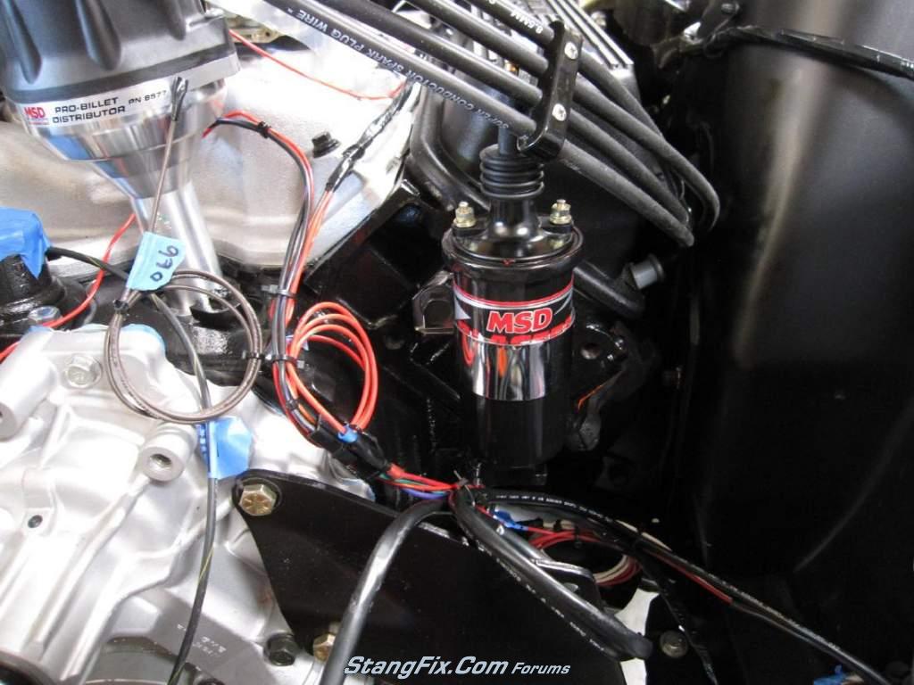

2nd pic has the clamp relocated to a lower hole but will not all the coil to sit vertically, thus angled.
If I had a choice, I'd prefer to keep it vertical but maybe this isn't going to happen?
I've never found that good plug wires crossfire. Old / crappy ones, but not good ones.
Mount it vertical, with those wires you won't have an issue.
I agree with mounting it vertical. Can you lower it some, so it's not as close to the plug wires?
Well, I can always try it vertically for awhile to see what happens. Can't lower it too much more due to bottom hitting the powersteering pump.
What about mounting it to the inner fenders away from heat and vibration? Depends on the look you are going for though. Some coils were mounted to the intake manifold, which may be another option.

Nah, Don't like horizontal mounted coils. I'll try the pic A attempt. Gonna try to modify the clamp to allow the coil to drop down a little more.

You do realize that you don't need that contraption on top of the coil, right? That will make the coil much shorter, and you can mount it like you have it.
It just means you use a different fitting on your coil wire than you do on the rest of the wires. No big deal if you're making custom wires, which I assume you are.
