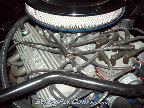

I put mine on the drivers side head. Here is an old pic.

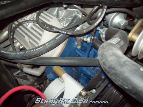

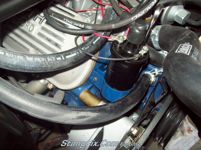

Here is what I am working with...
Note I only have the coil on the compressor bracket because I have nowhere else for it now and the compressor isn't here yet.
So I was looking at the passenger head area again last night, and I think I've spent too much time focussing on that bolt that holds the engine tag and the dipstick tube.
I think I might be able to slide the coil in the bracket from the opposite direction, and attach the bracket to the lower bolt hole in the head, low and right from the gold spacer pictured above. The coil would side cockeyed, tilted towards the passenger side of the car, but I think that might work.

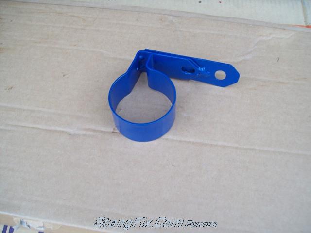

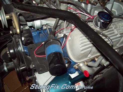

The other bolt hole didn't work. I went ahead and welded an extention to the bracket and mounted. I'm still not sure I like it but here it is.
Yeah, my only concern is the coil sitting so high in the bracket. I normally mount them with the bracket centered up on the coil.
