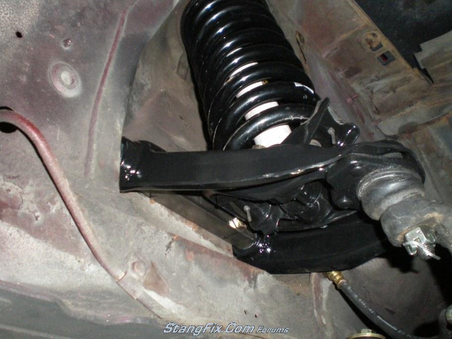

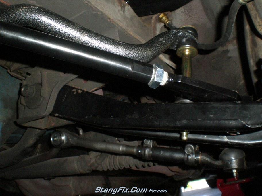

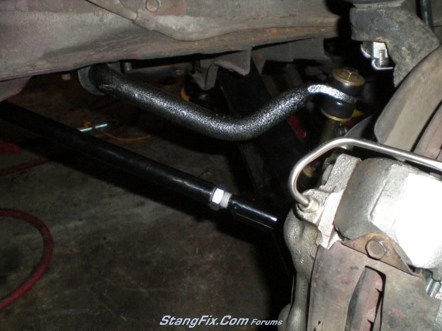

Oops ... my bad:

Nice suspension porn! Is that a Hellwig swaybar? I got one for my 65.
I don't honestly know the brand on the sway bar. It's whatever John sells. I know that SacBilll, has the same one on his '67. It's a good question, that I'll have to ask John, if he doesn't chime in here.
LOOKING GOOD. By the coating on the sway bar, I would have guessed it was from TCP. That what my strut rods look like.
My sway bar from Maier Racing has the same powder coated finish. I have a feeling all the Mustang vendors purchase from the same wholesaler.
Mine's the same one that M+ sells.
"Opentracker" said:
The sway bar is from M+ ... made here in Calif.
Thanks for the update, John. It's a nice sway bar, and I think the finish on it will make it easier to keep it looking clean.
