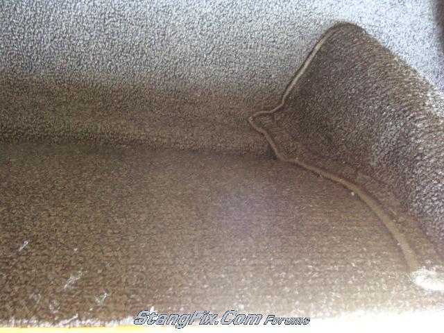

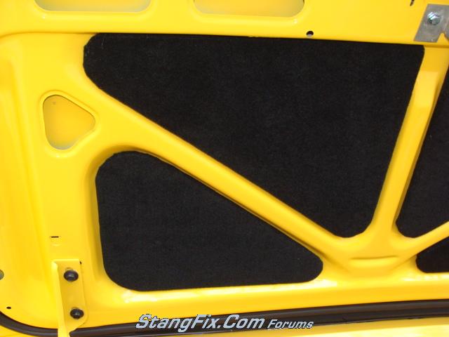

Here's a little sump'n-sump'n I whipped out today. They're decorative insert panels for my trunk lid. They're made out of 1/2" styrofoam insulating board I got at Lowes. It's got foil on one side and clear plastic on the other. I glued on some "carpet" that I got from Auto Zone. It's carpet in name only as the nap on it is VERY fine and short. It's not really carpet, but it was perfect for this project.
I also applied this material to the back of the well liner for a clean appearance.
And here are a few shots of the finished trunk. I installed the Distinctive Industries carpet kit.
I'm having a custom spare tire cover made. The one that came in the kit was too small for my spare, which came out of an '03 Cobra (required to work with my Bullitt brakes).
