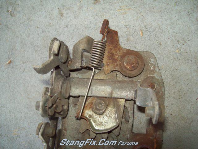

This will be tough to do without taking the time to photoshop in some arrows, but here goes...
Back side of latch. There are 3 springs that hold levers in place, with the clean looking one being the only one available to replace that I know of. The clean looking one is the one that keeps the door latched, ie, holds it shut when its closed. The rusty looking one on the bottom is attached to the levers that you push on the handle outside or pull handle inside to open the door. There is one more spring on the left side as pictured that you can't really see. Its attached to the locking lever, which is the one about 1/3 down from the top that goes sideways with a fitting for the key cylinder and the lock knob.
In this side view, the verticle bar is hooked to the lock lever. In this picture the door is locked. When you pull the lever to open the door, that bar goes up but does not engage the little peg sticking out that releases the latch. Upper left corner as pictured there is a rectangular hole in the assembly with a little peg sticking out. That peg is what releases the latch.
This picture is what you normally have with the door open and the latch disengaged, ie, ready to shut the door.
This picture is what you normally have with the door shut and engaged on the latch striker. Notice there is a notch in the upper lever that is engaged on a another lever. Follow that second lever down and you will see some gears where it engages with the other side of the latch piece. If that upper lever is not in the raised position, you will not be able to force the latch open.
If you are unable to open the latch, reach in and feel around the top of the latch and feel for that peg that sticks out. You can lift it up with your fingers and it will release the latch. Assuming the door is unlocked, there is nothing mechanically that keeps your door handles from opening the latch even if one or more of the springs are broken.

Hey all thanks for your quick response. sigtauenus thats for the detailed post, i figured it out this morning. I took the latch out and basically forced the two cogs apart with a screwdriver, not quite sure of the exact problem but it works now and thats all i needed. Thanks again
