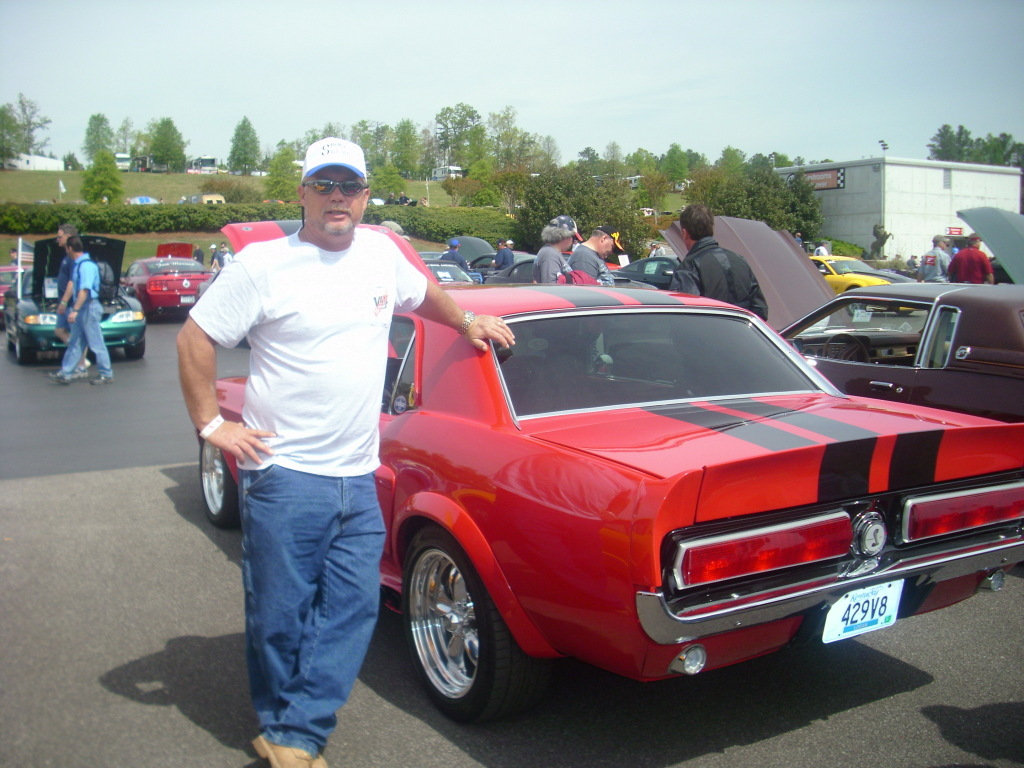

I have a 67 coupe with a GT/CS type FG deck lid, I retained the stock torsion bar rods. It's been on the car since the 90's with no warpage. You could use it to go pumpkin chunkin though, I have an electric trunk release and with virtually no weight it will open rather quickly (at warp speed)! here is a pic of Dave and the car
