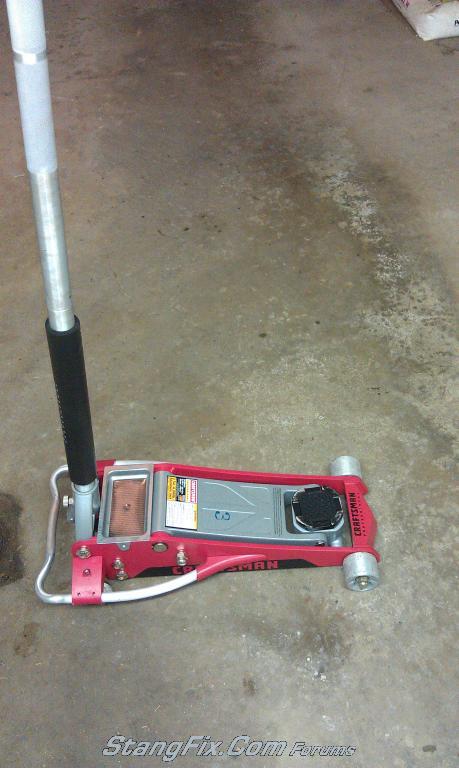

The Craftsman:

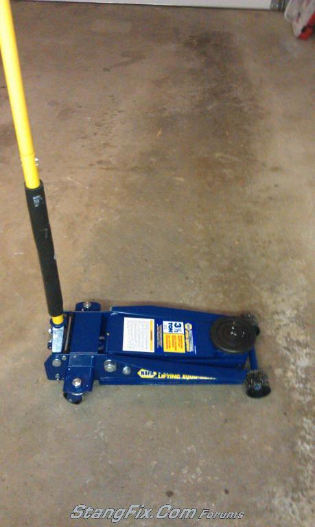

The NAPA:

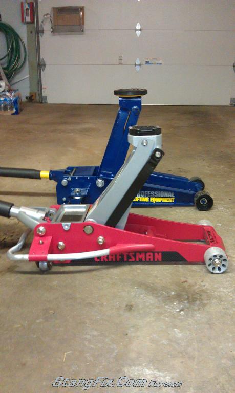

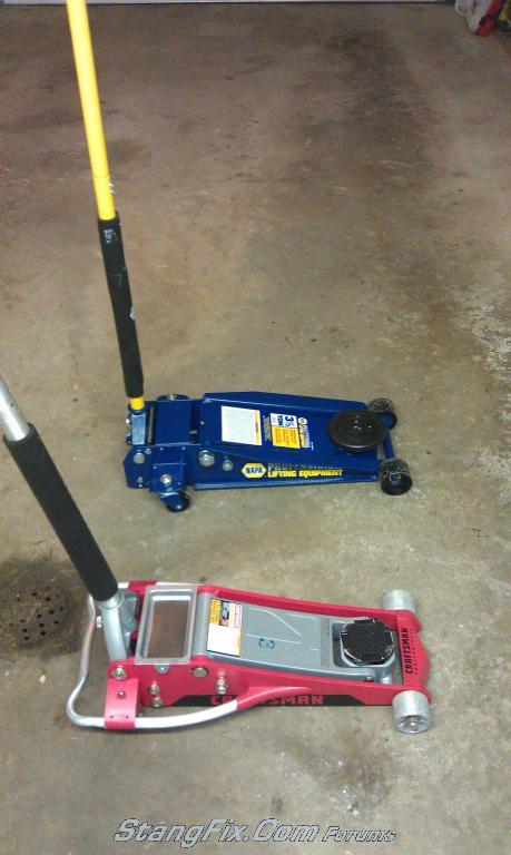

Side by Side:
