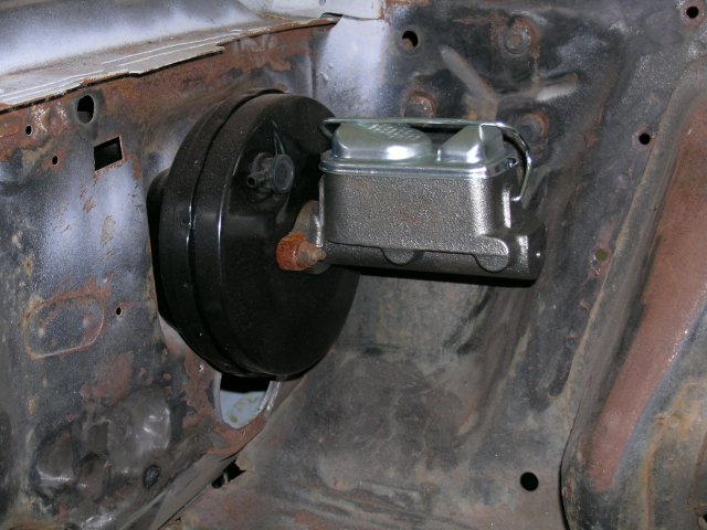

Craig I tried both the narrower (but longer) V8, and the shallower 4cyl ones on my '66. I am using a Maverick disc/drum MC. Both will clear the shock tower in this combination. The V8 fits....barely. IIRC it ends up about 1/2" from the tower. I ended up going with the 4cyl one for aesthetics. Keep in mind while the M/C's all have the same pattern and will bolt right up, the PB will no longer line up with the existing holes in the firewall. You'll need to redrill to the different pattern.
Doooh! I guess I coulda posted a pic too. Forgot I had taken one with it installed. Now you can see if you like the set up!
As you can see, plenty of room with the 4cyl PB.
Craig I shoulda asked, is the car gonna run an auto or manual tranny? If manual, the 4cyl PB causes some issues fitting a clutch cable or linkage.
