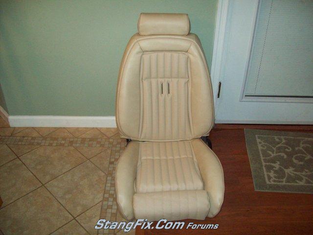

Thanks for those pictures Jon, particularly the one showing the new seat next to the original in the car. I didn't realize the older seats leaned back as far. Perhaps I'm not too far off.
Funny, those red Fox body seats are the same that I started with.

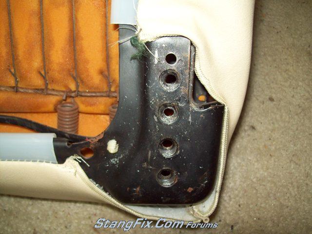

I used the original tracks. I used a factory bolt hole on the front of the seat and drilled/tapped a new hole for the bolt on the rear of the seat. Effectively this should have shifted the seat rearward, as opposed to using the bolt hole on the rear of the seat and drilling a new hole up front. The difference would have been about 2" or so (memory, not measured).

I have '89 Mustang GT seats in Scary. Now I'm only 5'9", but I used the '69 seat tracks. I didn't notice any difference in height from the original '69 seats.
The GT seats have a higher head rest, electric lumbar supports, and adjustable thigh bolsters.
Here's the passenger seat with the track installed. I used the forward factory mounting hole, and drilled and tapped the hole for the rear (top hole in close-up) There was enough metal reinforcement behind there at that location to have a pretty solid mounting point.
