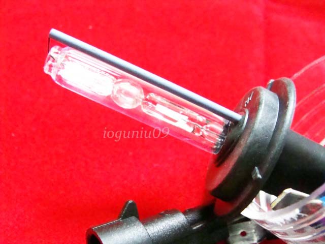

Found these adapters. They adapt true HID D2R and D2S bulbs to fit in a halogen H4 7" globe. Tried one last night and was amazed to see the difference. In my Cuda, the H4's I suppose were an improvement over the sealed beams but I still had to run with brights to see adequately at night.
Here is what the bulb looks like in the H4 adapter:

His post on the VMF is more detailed and has info on those H-4 adapters, and I believe he is forgoing the high beams.
Yup - got the adapters off of eBay for $18 shipped. My 72 Cuda uses 7" globes. I was thinking on placing some halgen fog lamps under the bumber like a 70-71 model. If this works out, I plan to do this on my 70 Mach 1 as well
