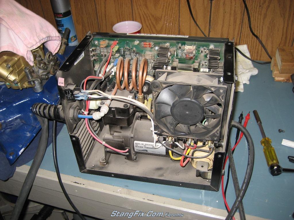

Just got home and haven't had time to call Hobart, but here is a picture of the inards... the yellow thing in the lower right corner is my suspect
maybe there are still some "corn squeezins" left in that copper tube from when you had it on your still. i know how you do things up there in kentucky.
